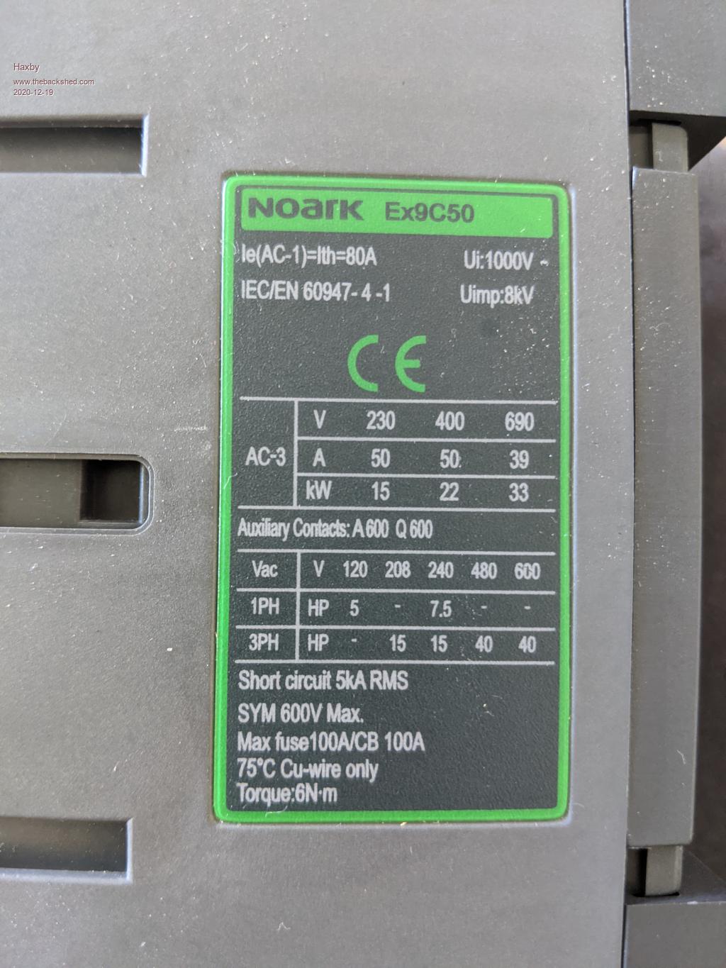

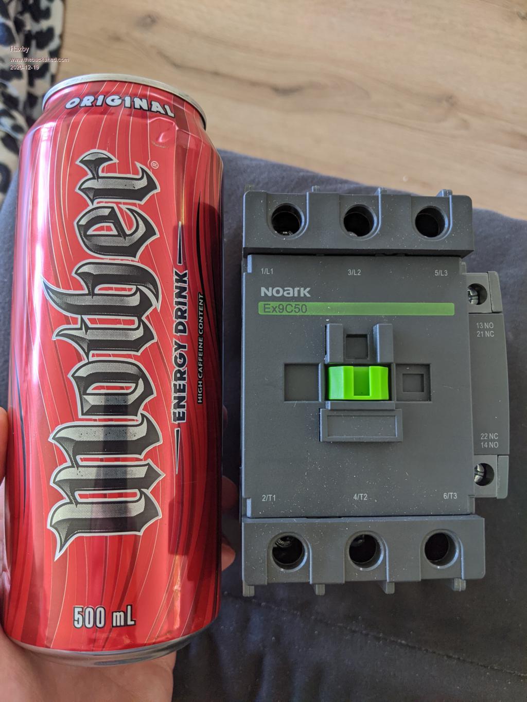

Hi all,
I bought a few of these beefy 3 phase contactors for peanuts when rockby electronics were liquidating them.
I don't have a specific purpose for them yet but was wondering if they would be ok to switch DC despite not being rated for DC.
I'd imagine the distance between the open contacts would be the deciding factor to work out a derated DC voltage rating. Any other thoughts?
