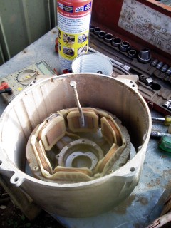

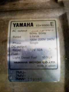

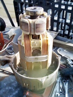

Hi all , would anyone have any sugestions as to what I could do to this burnt out unit, it spins beautifully, but smokes when spun at 3000 rpm. is there any use for it as is, other wise I will start stripping the copper wire out of it, it did have a 12V 10A DC outlet, is that the small windings at the top, or is that the exciting winding, as there is only one magnet, a small one that the nail is stuck to?

If it were mine I'd certainly be tempted to try to repair it. A working 5.5kVA generator is always nice to have and worth much more than its copper scrap value.
In the top picture, the top part of the rotor (with the 6 pole shoes) appears to be the excitation generator that supplies power to the field (2-pole part of the rotor, below the excitation coils on the rotor).
Can't be hard to find the fault. By the look of the blackened stator coil in the top picture it appears to be burned out. Shouldn't be too hard to remove the statorwindings and rewind. Throw in some new bearings for good measure and she'd be as good as new.Edited by Dinges 2008-08-31

If you feel a rewind is too much, you can resort to a barbaric act.....
If you can carefully remove the faulty winding (hack it out), and replace it with a piece of wire(bypass it) to complete the circuit, you may get it to work pretty well. You can not just short the faulty winding, it must be removed or it will probably try to toast itself.

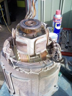

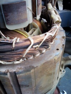

Now now you two.... the burnt coil is the one conected to the red(+) wire, and the three coils next to it have one wire blackened too, would your " Hack fix" just cause the next winding to fry? and by how much would it be de-rated?
BTW, priced a rewind for it, for $100 more, bought an NEW 8KVA....
The bearings are perfect.
What speed would I have to turn it at to get some useable power out of it( not AC ,maybe rectified DC),It was ment to run at 3000 rpm.
I would like to run it on my VWT, only spins at 100 to 150 rpm, it has the torque to take a 5:1 step up, and I have the wind here to keep it turning.
If I can find a use for it, it would be worth more to me than scrap value.
Thanks Grolly

I found on further examination that one compleate side of the windings were burnt, so I am attempting a rewind.

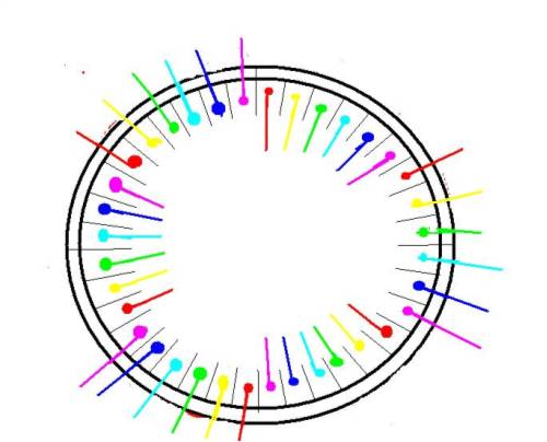

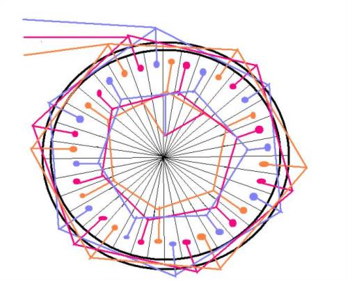

Would it be easier to rewind it to put out 240V AC @ 50 Hz, or rewind it to produce an AC output that I could rectify to 48V DC ?
There are 36 slots, so assumeing that I can spin it at 3000 rpm, what would be the output if I rewound it useing a coil 6 slots wide and haveing 18 of these coils?
Or haveing coils 3 slots wide and haveing 12 if these..
Or am I barking up the wrong tree?

To attain full rated output power of your generator you'd have to run it at rated RPM. At what speed the excitation winding starts exciting ? Impossible to say. Probably at 0.1 RPM, but the output would be immeasurably small.
Either 48V-ish ac or 240Vac could work, as long as you make sure you wind it in exactly the same slots as the present windings. If you'd go for 240Vac it'd be a simple copy of the present situation, guaranteed to work; if you want to have 48Vdc battery charger at 3000 RPM, you'd have to do a little math as you're basically re-designing the generator. (just guessing here; but if you rectify you'd want at most 60Vdc for floatcharging, so 60/1.41 = 42Vac (at 3000 RPM))
For 42Vac, you'd need 42/240 = 0.175 times the amount of turns the coils have now. Also, to have same rated output power (5.5 kVA), wire diameter would have to be 2.4 times as large.
If you start unwinding the generator, measure wire diameter and count the number of turns each coil has. Then choose a wire diameter that's 2.4 times as large and wind a test coil of 0.175 times as many windings. See if it fits. If it does, wind the other coils and insert them in the right slots.
The above w.r.t. rewinding for 48V only applies if there's no 'feedback' of main power to the excitation field. I can't tell if there is from here. If part of the stator output is used to supply energy back to the field (the single magnet is probably only there for bootstrapping the system) then rewinding to any other voltage would be much more complicated (if not practically impossible without rewinding the excitation generator too).
  Quote  There are 36 slots, so assumeing that I can spin it at 3000 rpm, what would be the output if I rewound it useing a coil 6 slots wide and haveing 18 of these coils?
At 3000 RPM you should be able to get full rated output power, as long as you have the same 'slot fill' (amount of copper per slot). That's why you want to calculate how many turns and how thick wire you can still fit in there.
I'm not sure what to make of your drawings; whatever you do, make sure that you're rewinding EXACTLY the same as it is now, only with different thickness wire and different number of turns.
