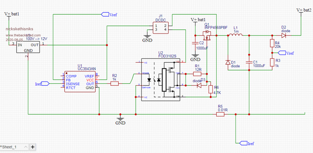

You would like to build it yourself?
The easiest way is to use a resistor, and a relay to disconnect when end voltage is reached.
But I think you would want to use a buck converter to maximize efficiency, I would suggest to use a current mode pwm controller like UC3843, so you have current limit and voltage limitation. You will need a small dc converter to convert your (high) battery voltage to 12 or 15VDC to power the ic, you will need a gate driver like TLP250 of FOD3182 to drive an N-channel mosfet. Because the mosfet will need to be in the V+ line. Therefore you will need an isolated dcdc converter as well.
You can read the solar MPPT controller topic for guidance on a high power buck converter and make a smaller version. As you want to charge a battery you will need to have cycle by cycle current limit, so it's difficult to implement it in a µC, not impossible though. But I think a dedicated pwm ic is more suitable for this, for safety reasons you will need an extra diode in series with your output.
This is just for principle, schematic is not complete and values are not correct:
I'm not confident about the current measurement, it's possible it needs to be measured before the mosfet. But there are solutions for that.
I hope this is a good startingpoint for you.

nickskethisniks
Joined: 17/10/2017
Location: Belgium
Posts: 499
Posted: 04:40am 06 Aug 2020
You can drop it if you put the MOSFET in the negative side, then you can drop the optomosfetdriver also. And drive the MOSFET directly from the IC.
But then you can't measure output voltage on a simple way, you need to figure out how to measure that if you want to have voltage regulation. (or not). I think you can achieve that with an optocoupler.

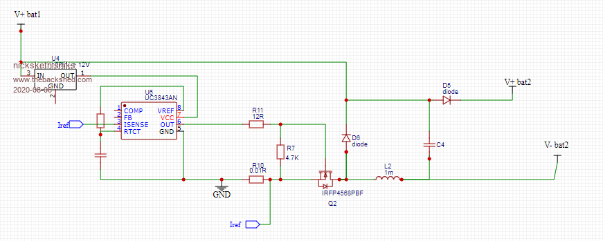

But you would still need some kind of comparator/opamp circuit with a mosfetdriver?
Something more like this?
Posted: 09:32am 06 Aug 2020
That comes pretty close, 8.4v undervoltage lockout, 100% duty cycle, all good.
Pin 2 voltage feedback would need to be grounded to produce the maximum 100% duty cycle.
Problem though with I sense.
That needs to go up to one volt, and a current shunt that generates 1v is not practical.
A single supply rail five volt Hall current sensor powered from v ref should work though.
Set that up to provide one volt output at ten amps (or whatever) and you should be in business.
The UC3843 works up to +30v supply, so the twelve volt regulator is not really required.
A nice circuit with very few parts.

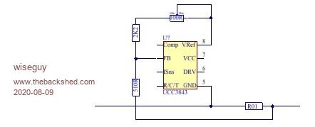

A cheap & simple fix is just to add a 0.9V offset to the I sense feedback signal.
When the upper variable resistance is trimmed to ~66R (2266 ohms total) the current through the 0R01 is ~ 10A.
Edited 2020-08-09 14:07 by wiseguy
Cheers Mike

Warpspeed, you mention the 12v regulator is not really required. Are you implying I could get away with a simple voltage divider instead?
Wiseguy, your idea looks good to me, but what happens to the Isence input?
Thanks Steve

Joined: 21/06/2018
Posts: 1326
Posted: 04:06am 11 Aug 2020
Hi Steve, Whoops my mistake, the tapping of the two resistors should have gone to the current sense feedback (Isns) not voltage feedback. The FB could be connected to Gnd as per Warps suggestion or used to set the max Charging voltage via an isolated sense scheme.
A few words on what is happening inside the IC might be helpful. When the FB pin is higher than the internal 2.5V reference the PWM is truncated each cycle until the FB = 2.5V.  When the Isns is greater than 1V the FET drive output is truncated until the next cycle. The data sheet is misleading with regard to VFB & VRef, see data sheet Pge14 says about Vref (5V) "VREF is the voltage reference for the error amplifier" which is crap, if you look at the internal schematic 2 pages earlier it shows the error amplifier is internally connected to 1/2 Vref (2.5V). When I previously wrote 5V for F/B it did not look right hence this edit.
