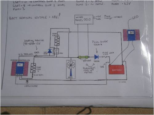

Karl how does this work any chance of getting a simple diagram of your setup please.

Here is a schematic i drew a while back, it has evolved a little but more in the layout than the schematic as such.
For next time, I'm going to lash out and buy an LAtronics TC48 or TC96.
Unless you can get batteries real cheap (i got mine for less then $1/AH for new AGM's) and they aren't cheap enough!
160AH = $600 PL20=$280 thus $880 + everything else required for a battery system.
$800 gets you a TC 48 turbine controller and dump load.
My circuit is suitable for use with any Grid tied inverter and prevents it seeing too much voltage which it would do if the grid went down.
Poof - all gone!
the circuit for battery charging shown on the site is AOK for a little GTI and a small battery bank.
ie 40AH would do it, smooth it out enough not to smoke these GTI's.
They are illegal of course (the power Jack jobs)
keep that in mind if you are hoping to collect any real money from your investment.

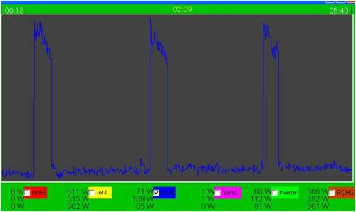

Posted: 01:26pm 07 Mar 2010
Hi Bob,
Yes the fridge is the key.
This was todays base load.
minimum power was 60W, and when the fridge comes on 189W. approx duty cycle of the fridge is 20%ON.
Gordon.
