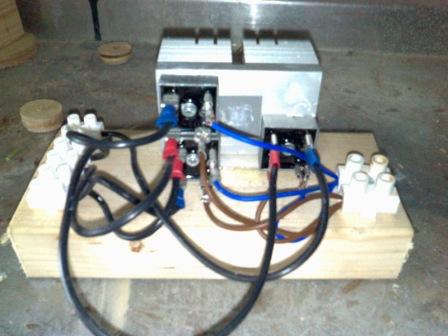

I am in the process of building a Wind Generator using information advice from both this and a whole host of other sites. I plan to create a full home grown version but for a Mk1 I have used an old solenoid from a set of spot lights. This is cast in resin and mounted waiting for some wings to get going
I have tested the output by hand and got a fair few Watts (AC) showing on my volt meter. But when I connect it to the bridge rectifier nothing shows up at all
I have checked the rectifier (it is also a home brew) but it seems to be wired up fine (both outputs from genny going to ac connectors then DC output connected to + and - terminals)
any ideas anybody ? I am missing something simple
Picture below of the rectifier

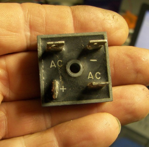

Regarding the lack of DC, as you have verified you are getting AC power from the generator, the prime contender for lack of DC must be the rectifier. Looking at the photo, to all bridges I see the black (AC?) wires going to adjacent terminals whereas they should be going to diagonally opposite terminals. Likewise the DC wires (blue and brown?) are from adjacent terminals instead of diagonally opposite ones.
The pic below shows the terminals clearly marked. Note the lug orientation. They are the same for all these types, so making it easier to locate appropriate pins when the markings are gone.
Easy enough to change the spade connectors. How does that sound?

I had identified this already (old photo) and have changed them around - still no luck though.

Then you only need one bridge rectifier not 3 as showen in your picture.
Conect one solenoid wires to each of the two~ or AC terminals as showen in Gills picture and you DC comes out of the + - terminals.Edited by Robb 2008-07-22

I had built it for a 3 phase project. I have only connected one of the rectifiers up as suggested but still no luck - this is very strange.
