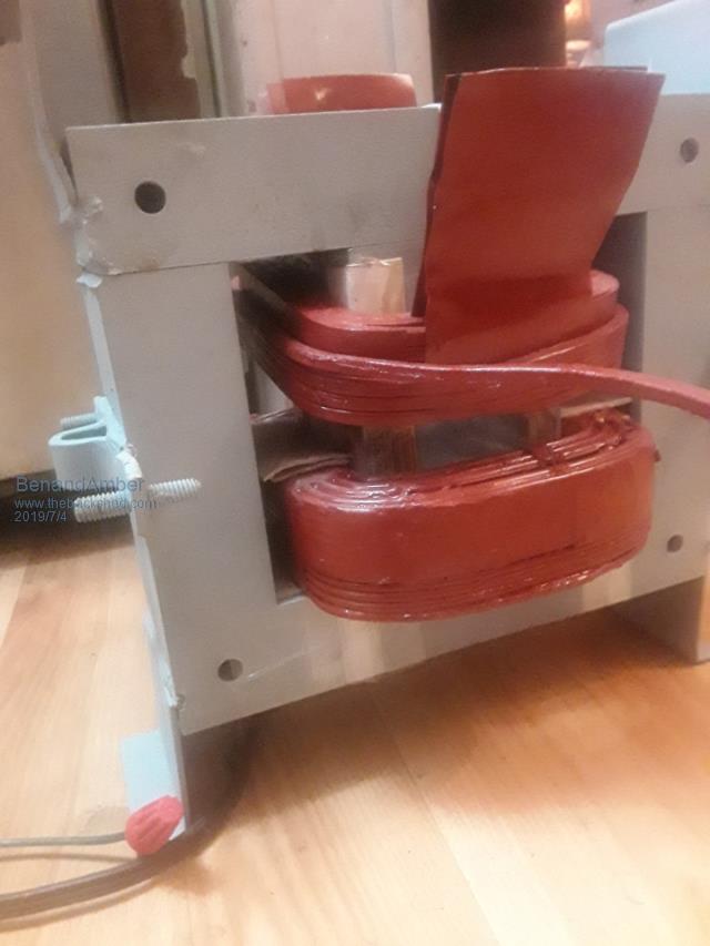

This Transformer weighs almost 70 lb this is the Transformer
I would like to use to make a power supply
I will be rewinding the secondary lower voltage side so I can put in as many taps as necessary

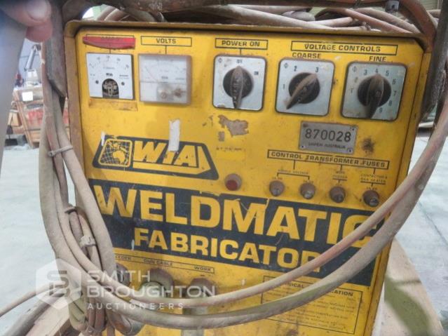

Try and find an old transformer MIG welder.
This is a picture from the internet, but you will see it has two switches that give 27 different primary voltage tappings on the transformer. Output voltages might as a guess be in the 16v to 55v dc range.

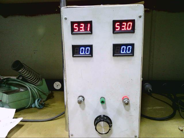

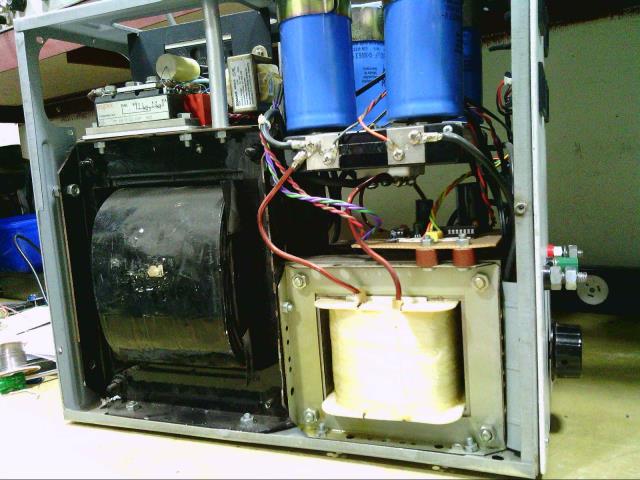

I have had a few goes at different times building really big dc power supplies, and none of them ended up being really nice or easy to use.
The simplest is probably just a big transformer, bridge rectifier, choke and electrolytics. Then adjust the voltage to the primary of the transformer either by phase control with a couple of SCRs, or better still a large variac.
No voltage regulation and no current limit. When overloaded it just pops the circuit breaker on the main power board.
I built it into an old computer case, zero to +/- 50v at about 20 amps continuous. Its ultra crude and very ugly, but can be useful sometimes for a bit of rough dc power.
