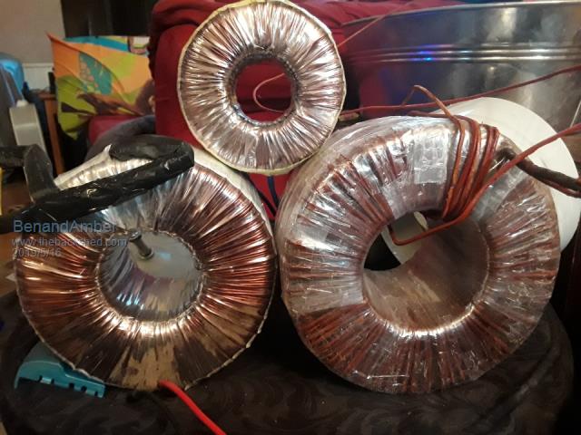

Here's a pic of the one I built out of little ones I've only got one layer of the winding on it so far 44 turns
It's the one on the right
The little Transformer on top is a lot like the ones I built it out of
The one on the left is out of a 8000 watt power jack so who knows what the wattage is on it

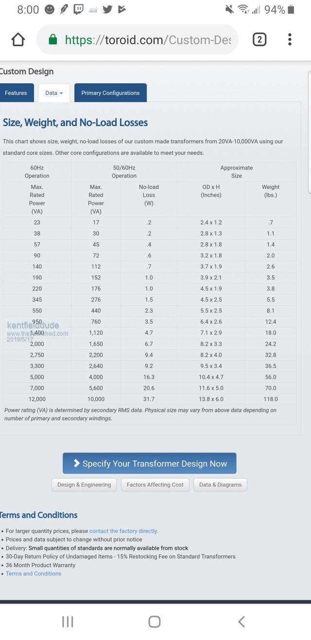

I currently talking with toroid.com. what size core do you think will be best?

  kentfielddude said   I currently talking with toroid.com. what size core do you think will be best?
WONDERFUL!
Please keep us posted with the cost, tax, s&h, insurance.
The table looks pretty exhaustive I think.
Personally I would look for the last two to power a family home. Our energy needs are 400kWh/month with 5kWh peaks

This is what they told me:
We have standard ID 80mm, 90mm, 100mm, 120mm, 140mm, 160mm and 170mm.
OD can be any dimensions two times of the ID.
The height is from 20mm to 75mm with increment of 5mm.
Posted: 07:58pm 16 May 2019
The figures they give are nominal for a typical commercial design run at fairly high design flux density, which is fair enough.
For an inverter, we would use a much lower design flux density by using a higher turns count. That forces us to use slightly thinner gauge wire, which reduces the maximum continuous power rating.
But we win hugely by having a far lower idling power than they specify on that chart.
The largest size would be ideal for 5Kw to 7Kw continuous 24 hour rating, and multiples of that for short surges.

Well they told me the ID:170, OD:340, H:75 is $447.
tinyt
Joined: 12/11/2017
Posts: 564
Posted: 02:24pm 17 May 2019
  kentfielddude said   Well they told me the ID:170, OD:340, H:75 is $447.
ID:6.7 inches, OD:13.38 inches, H:2.95 inches
This is huge for me.
This is only for the core, no insulating tapes, no winding? And no shipping and handling yet?Edited by tinyt 2019-05-19
