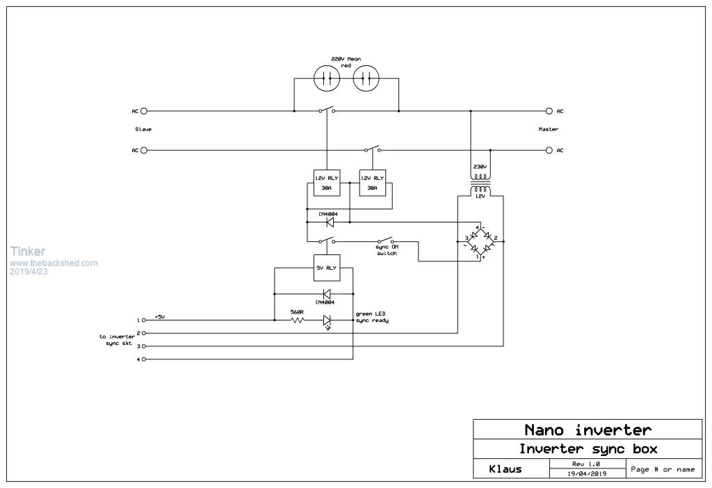

To connect the AC of my two test inverters together in sync I made this box:

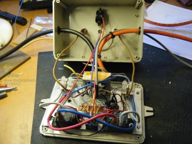

It looks plain enough on the outside but not inside :
It was surprising that the connections of the simple schematic created such a rats nest of wiring. Just as well I choose a large jiffy box as it got pretty full in the end.
Some explanations:
The two Neons in series indicate when the two inputs are in sync or not. They go bright when 180 degrees out and extinguish when in phase. Its just an indicator if a two trace CRO was not handy. BTW, that CRO must have its ground isolated. I use 100:1 home made probe adapters which can plug directly into a AC GPO.
The switch is the final manual control to synchronise, I did not want that to happen automatically - and just as well .
The green 'ready' LED shows when the nano inverter (Slave) has synchronised to the master inverter.

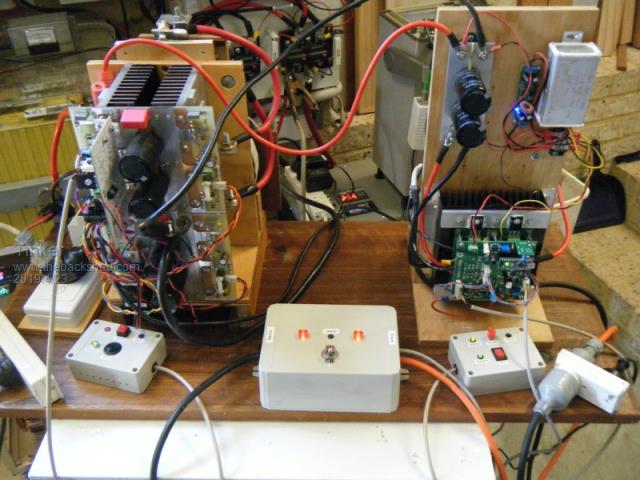

This is the test set up:
Setting up: Switch OFF, Adjust both inverters to the same voltage (230V), no load connected, both inverter outputs monitored by oscilloscope trace, Synch inhibit link in place on nano inverter control board.
The Master is a EG8010 based inverter, the Slave a nano inverter.

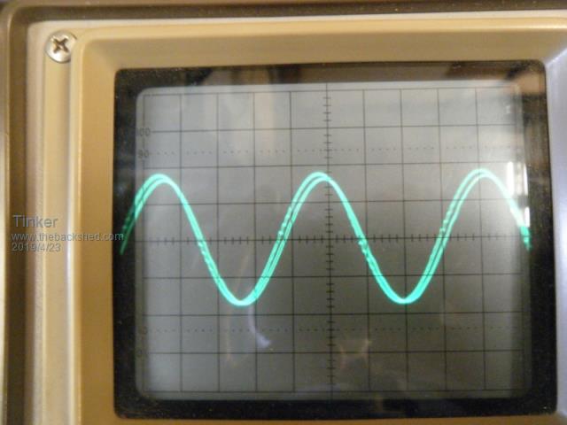

Try again, the CRO traces now in sync but not quite , see pic:
The 'serrated' trace is from the EG8010 inverter.
No idea why, so, after scratching my head for a while, I decided to throw the switch ON.
Well, no bang but the 5V relay was cattering badly and the sine wave developed a hump on its side.
