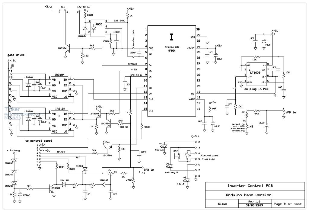

The control board uses a single nano with poida's code and only the essential functions beside the sync feature, to be able to fit on that size board.
The control board was designed to eventually replace the EG8010 based control boards that are in my other inverters, so it has provision for the connectors to suit that.

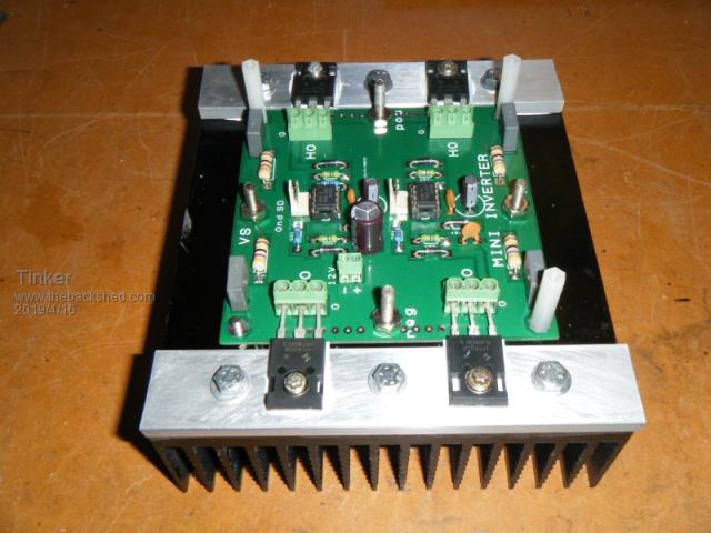

The power board looks like this:

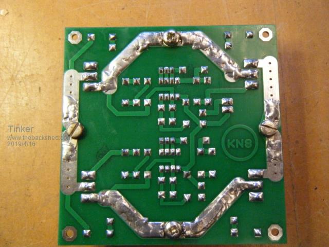

With a reverse side like that:
Note how I beefed up some tracks (the ones to the primary) with solder wick. The positive & negative power tracks are duplicated on both PCB sides for that purpose.
To avoid current hot spots I also soldered solder lugs to beef up the track, you may just be able to spot them under the screw heads.
Here is that board fitted to a single heat sink - doing that requires insulating washers *must* be used under the mosfets:

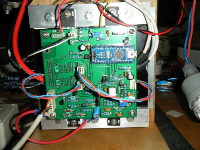

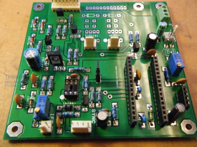

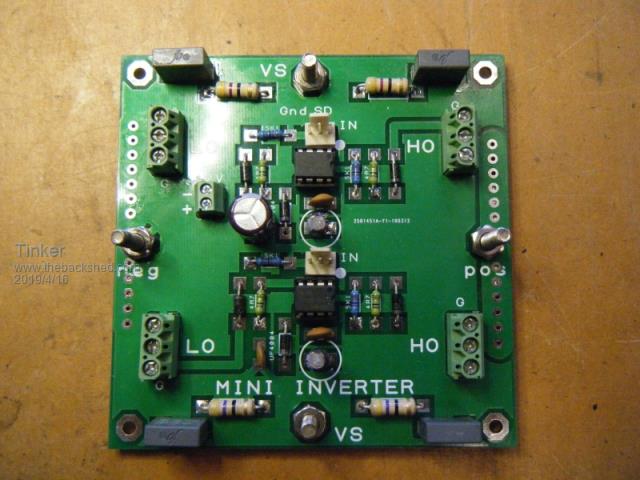

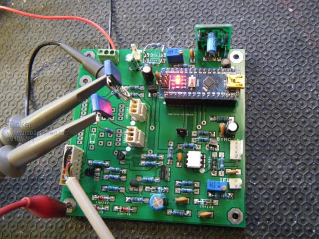

The control board looks like this;
This board can also accommodate the half bridge drivers, these will be fitted on my big inverter replacement boards as these inverters use totem pole drivers on the power board as well.
There was no room for the LT1638 filter on that board so I can fit this as a 4 way plug in little daughter board (next to the nano).
The nano seems to run well without that board (still waiting for that PCB), perhaps that has to do me using a ground plane?
The control board piggy backs on 25mm spacers, see picture further down.

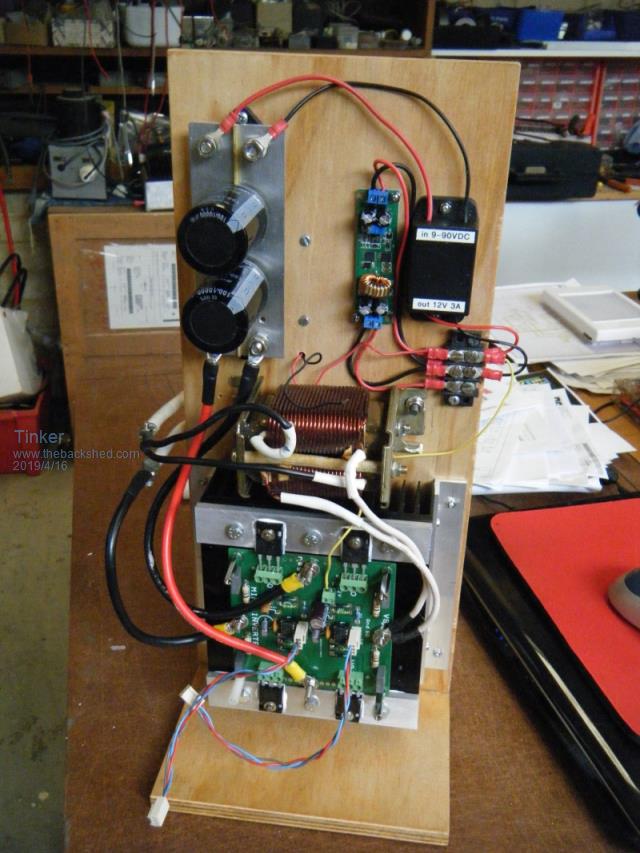

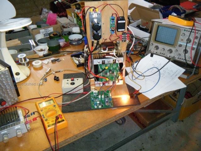

Now, in my experience, bench testing something that has many individual parts, like an inverter, requires a rats nest of wires an this resulting often in dubious connections. To avoid that, time spent to make a little plywood caddy, to fit all the parts, is well worth while.
This is what I came up with:
And here are the parts fitted to one side:
And the other side:
All being connected up, time came to apply power and see what happens. I used a small pilot light for a load as the inverter was powered by my bench power supply then:

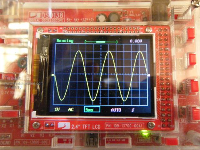

Well, it worked , with a beautiful soft start and stop. Nice clean sine wave too.
Further testing with a 60W, then a 100W incandescent light - still running fine. 200W lamp, still fine but not for long as the 10A fuse in my power boost module complained about too much load .

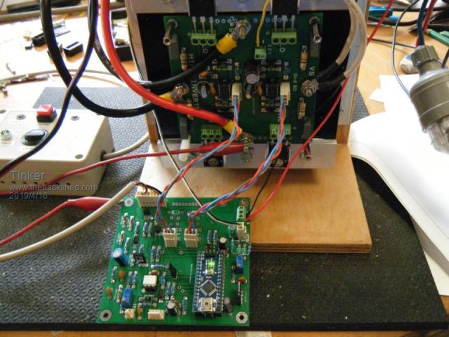

Here are some close up shots of the two PCB's connected up:
Note the plug in gate drive connectors so the control board can be easily removed.
A close up of the control board fitted piggy back to the power board:

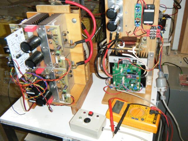

And here is the full power test set up, #4 inverter is located on the left and #5 inverter on the right:
There is a 80mm 12v fan behind the heat sink (switch controlled) but with a 500W load it was not required to run, the heat sink (and top of mosfets) were only 10 degrees above shed ambience temperature.

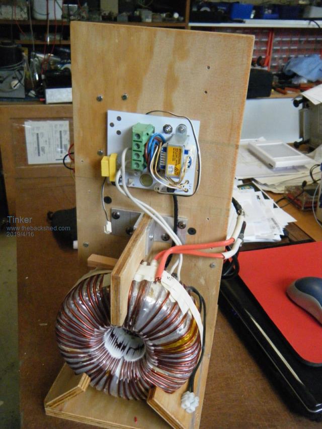

The choke got warmest, I used a small one from a 2500VA Aerosharp with both coils in parallel. I might experiment with different chokes here later.
The toroid, recycled out of a 1KW, 96V Latronics inverter, uses the original secondary. This got warm to touch after running 500W for several hours.

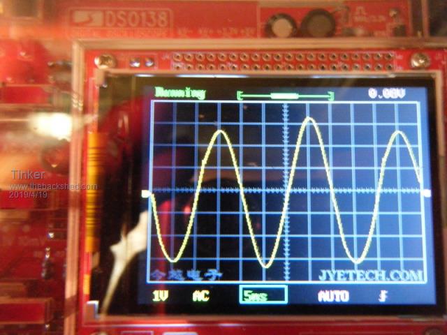

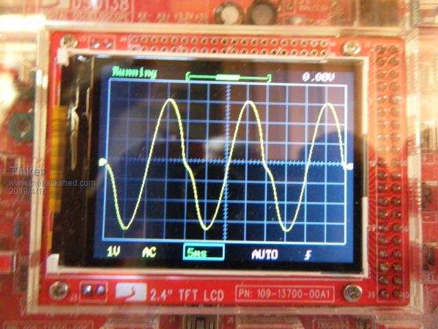

The sine waves are interesting, here it is with a 500W load:

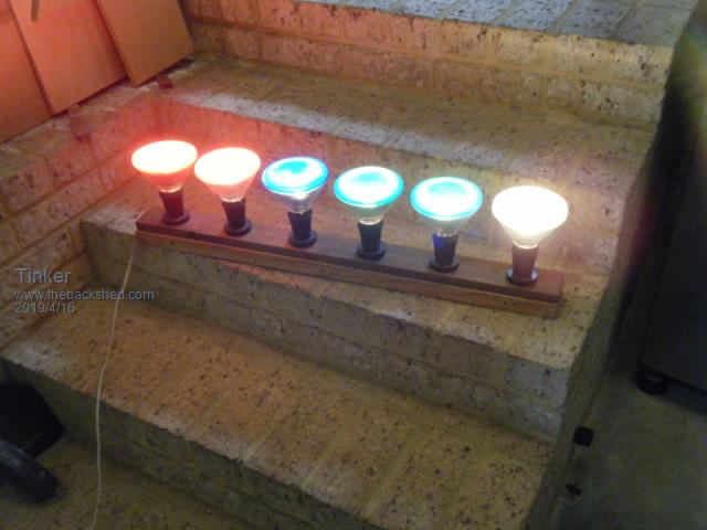

I use a light bar with flood lights as test load, this lets me increment it in 100w steps.
This is how the sine wave looks with 600W:
I have no idea what causes the down slope distortion yet, more experimenting with chokes perhaps required. No distortion up to 500W load, then it looks like something is working too hard.

The distorted waveform at 600W has me puzzled. There is a hint of it at 500W in the above image.
I suspect the toriod might have suffered a big whack at some time, and is magnetised as a result. But also, you might want to verify correct DC supply to all 4 legs of the bridge. At zero AC voltage crossing, we have max AC current.
I am thinking you might see the kink on the upward slope, from negative AC voltage past zero to max +peak. Just change the two primary wires around and the scope's sample wires, to retain the same "sense".
That way, you only change the current direction?
Are you able to show the primary current on the scope too?Edited by poida 2019-04-17

I'll try swapping the primary wires tomorrow.
The sinewave was probed across the capacitor at the secondary - easiest to attach probes at.
If you look at the PCB tracks of the power board, there is nil chance for unequal DC to the bridge (assuming you mean the Mosfet power source & drain legs?)
No, I do not possess a current probe for my scope. She's a 30 year old BWD dual trace/ 35MHZ old fashione CRO job with no fancy probes.
I took the pictures on the cheap little digital scopes as on these the full trace gets captured by my camera. There is an identical trace shown on the dual channel analog CRO but very hard too photograph with hand held camera.

I tried poida's suggestion of swapping the primary connections over, the distortion moved to the upslope then. I think it has to do with the choke as other chokes I had here all produced (different looking) distortion above 500W or so load.
The plan now is to make a decent non saturating choke for that little inverter.

I certainly will investigate that possible VFB interference. I try hard to avoid ground loops and the boards have a ground plane too.
But there is no VFB filter LT1638 installed as yet, the little daughter PCB for it has not arrived, due any day now. Will also try shielded wire for the VFB link, its about 30cm long.
I'll try turning that little transformer 90 degrees & see if there is a difference. Usually toroids do not have much of a stray magnetic field?

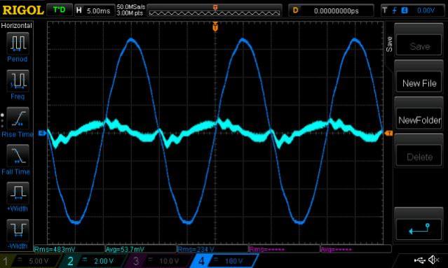

When all my inverters are running with zero load (idle), I always see
the primary current to be 90deg phase different with AC voltage.
This is typical: (light blue is primary current, dark blue is AC volts)
It includes some of the PWM induced wobbles, but that is not important to the point I make. It peaks around the zero crossings.
The non-zero current, when under zero load is due to the magnetising of the toriod core. It's typical of an AC circuit with an inductive load.
Not all of the power is returned by the toriod when it flows back to the inverter board. Some is lost.
Typical idle primary winding AC current I find to be 6 A RMS
The DC current is only 0.4A, at 27V.
11 W idle power.

That little PCB for the LT1638 filter arrived today and I fitted it to my nano control board. The inverter now powered 600W without distortion on the sine wave. I replaced the VFB wires with a shielded cable too.
Then I was wondering if that inverter can do more power and plugged in (inverter powering 600W then) another 150W floodlight.
That caused a 'bang' event . One of the HY4008's short and one O/C. Also the top of one IR2184 half bridge driver blown off.
It got too late to investigate why that happened, will do that tomorrow.
Fortunately no Mosfet leg fire happened, no visible damage to them at all. The terminals make it easy to swap for good ones.

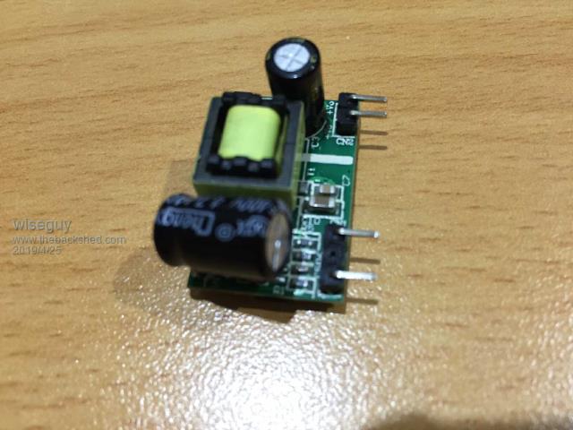

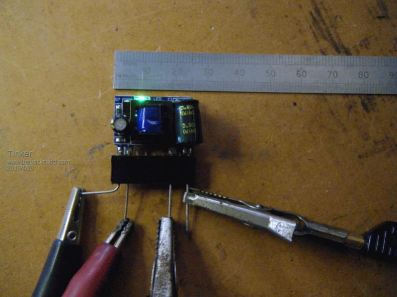

That 'bang' event also took out the little DC/DC converter, used to get 12v from the battery, my nose eventually told me just where the no low voltage problem was .
Here is a picture of the sine wave with a 1KW load (500W immersion heater + 5x100W floodlights):
One thing odd about that was every other peak was bigger and that alternated top & bottom peak, sort of moving along the wave train.
So I looked at it with my analog CRO, no such odd peaks but HF noise at the wave peaks instead. It looks as if that little digital scope does some kind of averaging, producing that odd sine wave.
The noise is because I used one of the ferrite chokes (E65 core, 4.5 turns) that I took out of my ozinverters for testing. I'm now making a non saturating choke using the C cores from the Aerosharp, those chokes made a big improvement in my ozinverters compared to the ferrite job.
Here is a picture of the plug in R/C loads to see the nano output waves. These make testing that very easy.

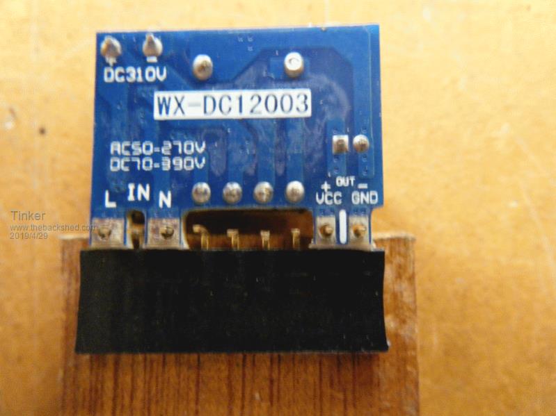

That little active filter board can be seen at top right, behind the nano, of the PCB.
