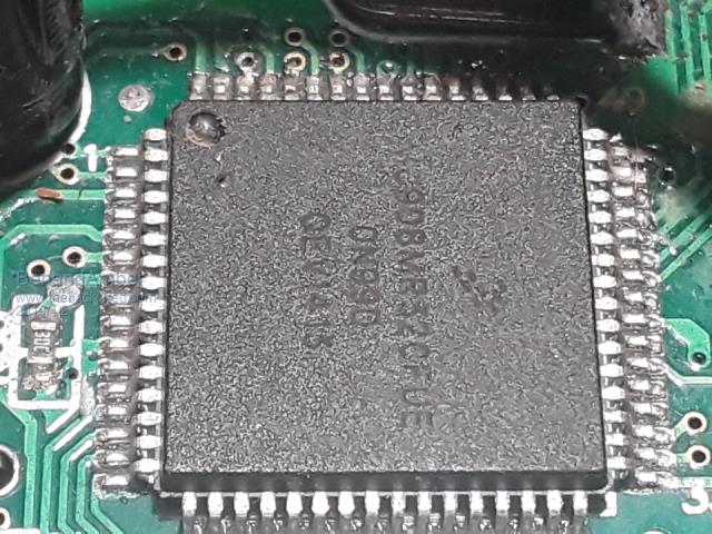

I've been reading about the brain chip on it it's a little bit like the 8010 but a lot less straightforward
I think you have to change a resistor out for the timing of the Hertz they use the same board for 50 hertz and 60 hertz
What is the part number of the chip and a picture of the pcb this is on. Not sure if I can help, but just curious.Edited by tinyt 2019-04-01

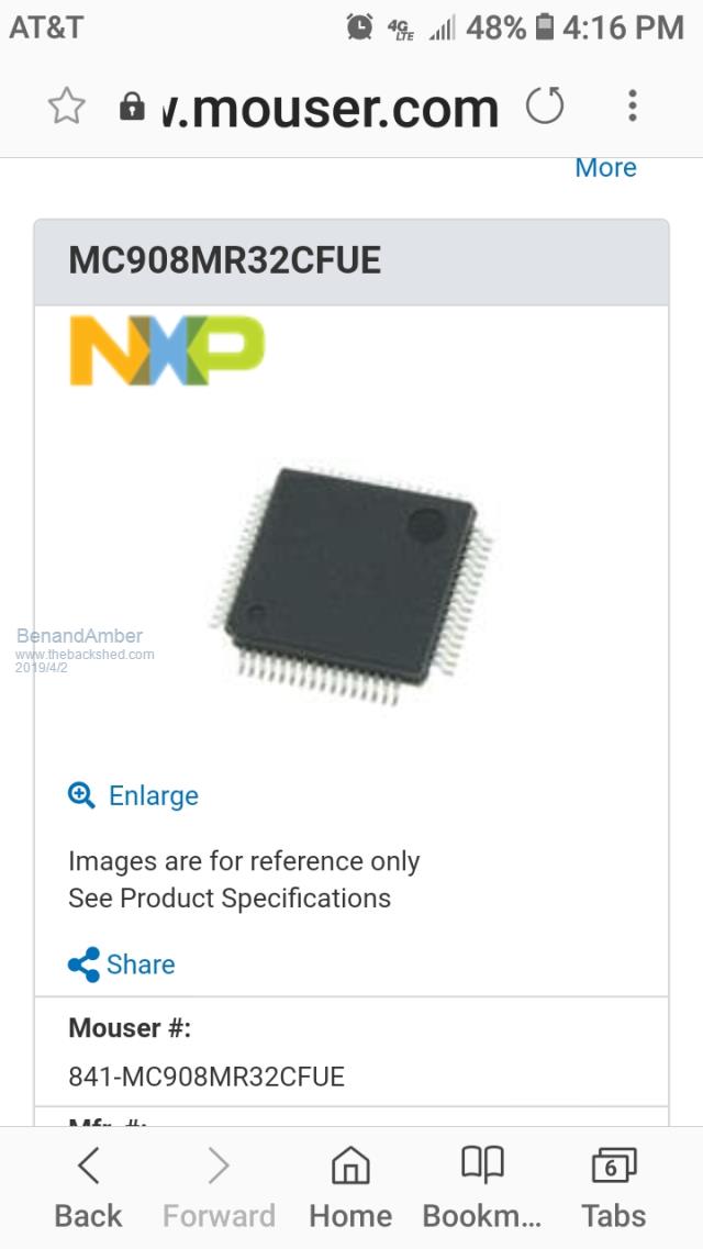

Mc908mr32cfue
on99d
Qev1413
Thank you for your time I appreciate itEdited by BenandAmber 2019-04-03

Mc908mr32cfue
on99d
Qev1413
My eyesight is no longer good. Based on the picture I think that resistor is connected between pin7 (PTC0/AD8) and pins10/11 (VSSAD/VREFL). It probably has something to do with analog voltage reading.
Unless we can reverse the design, schematic and code, I think this is an almost impossible task. If we can compare with another pcb configured for 60 Hz and if they are exactly the same, we can assume it is in the code as oztules said somewhere.

Posts: 961
Posted: 01:25pm 02 Apr 2019
No big deal Tinyt
I am very grateful for u taking a look at it and giving your good advice on it now I know what I need to do
Either find someone else that has the same board and compare it to this one
Buy a new power jack control board which I really don't want to do I just don't trust them from everything I've read
Use a ESG 0 0 2 do the modifications on it like poida told me to do on the little China inverter board
build me a little board to put the card on that has a 5 volt Supply and a 12-volt Supply
and a 120 volt to 12 volt teeny tiny step down Transformer for voltage feedback
then run that through a voltage divider circuit to get the voltage down to a little under 3 volt
I know it ain't quite that simple but I have a lot of determination and some good people on here to help me along the way
