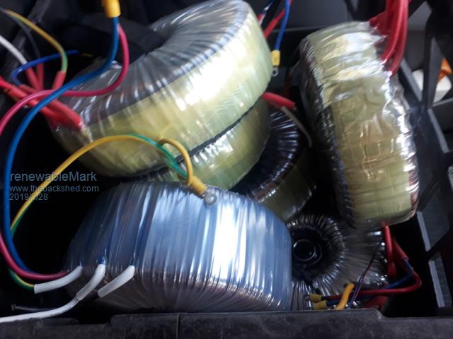

I have a double stacked pair of 3kw's. That has 128 turns on 4 secondaries, primary so far is 14 turns of 70mm2.
I do have plenty of that 70mm so can wind on as much that will fit, it wont be pretty though, reckon only 6 more will fit.
I can get some 25mm2, that should still carry 100 amps, or use 50mm2
No 2 torroid I have an unmolested 2kw aerosharp.
No 3 torroid I have an unmolested 2kw aerosharp.
No 4 Will pick up a 1kw aerosharp.

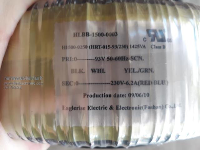

OK I'm not too great on calculating, so I'll need a bit of help with the torroids.
Batt volts is a 48v bank, my normal LV cut off for bank is 46.5, but it's never actually cut off in 6 months use, I think the lowest it's been under a heavy load was the low 47's.
No 1 toroid is already made with 2x3kw cores stuck together 128 turns of 4 layers secondary.
14 turns currently on primary.
So how many extra will I need on the primary?
No 2 torroid will be a 2kw core, I'll most likely rewind this from scratch, so what would be the optimal turns and number of layers for secondary and primary?

Posted: 09:45am 28 Mar 2019
Mark, lets do these one at a time.
If you design all of your transformers to have a 44.0 volt minimum, that will allow for a little bit of extra voltage margin for voltage drop in the mosfets and wiring.
With a 25 turn primary, the secondary voltage will be 44v x 128/25 = 225.28v
About 35mm squared wire should be about right for the primary.

Warp, that torroid is actually 127 turns on the sec, not 128, which doesn't work out as well @ 223.52v
I spose where they come out at the side I could add more wire and make another turn, or swap out the other torroid that is in the machine running the house, that one is 128.
