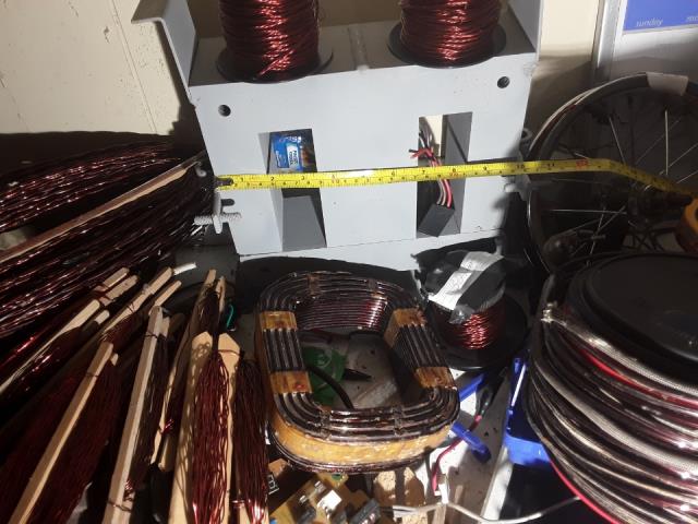

Posted: 03:50am 26 Feb 2019
This is the big heavy Transformer core I was planning on making into a 48v battery bank charger

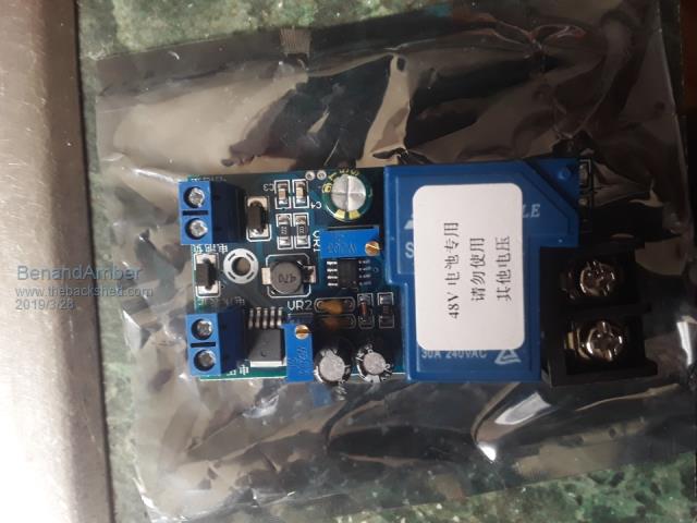

Posted: 03:58am 26 Feb 2019
This is the little shut off module I ordered off eBay
It was under $10 including shipping
got to love that China stuff
If I understand it right
it has a 30 amp relay on there that goes on the main side of the Transformer in series
So on the secondary I was thinking I should at least be able to get 60 amps including all the losses
is this thing so big it will flip the 20 amp 1 20 volt breaker with a really dead battery Bank
I think that breaker will probably flip it around 18 amps
the breaker should do a little over 2,000 Watts
at 60 amps should only be about a thousand Watts on the secondary other Transformer
I may be going at this all the wrong way
I may need something to limit the amps
please chime in
I appreciate the helpEdited by BenandAmber 2019-02-27

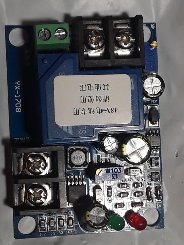

Posted: 02:23am 28 Mar 2019
Picture above was the wrong module shipper sent the wrong one so I ordered the right one

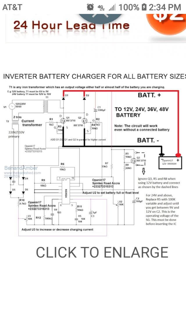

Any thoughts on this battery charging circuit
In this post earlier somebody mentioned using an mppt charge controller which sounds pretty awesome alsoEdited by BenandAmber 2019-07-27

  BenandAmber said
Any thoughts on this battery charging circuit/QUOTE]
That's a strange circuit you have there, the 2 mosfets will always conduct on -ve cycles, regardless of their drive due to their internal diodes, wired as they are, at best they will turn on harder shorting out the diode. In effect there is an uncontrolled bridge rectifier supplying DC to the battery... just doesn't make sense, are you sure that is a validated circuit or has someone posted a theoretical schematic that has errors in it.
Please post a link to the original.
Mike
