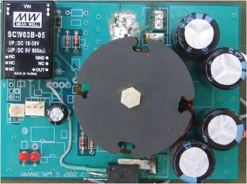

Posted: 02:30pm 23 Jun 2008
Hi Gill and Oztules,
I had no idea that dom was only intending chopping the DC from the windmill.
I see that a MPPT is a program that continuously adjusts the pulsewidth. An inductor and associated componentry convert one VI to a different VI based on the ratio of on/off time. The microprocessor makes measurements and decides if the power level has increased or decreased from the last time a measurement was made. The micro ultimately attempts to track the maximum power point. The word maximizer has been used for MPPTing.
I have used maximizer to distinguished a difference in operation to a MPPT. The concept I am adopting is where the electronics already knows the correct loading to apply. The TSR of the windmill may vary a little through the loading curve. My code is adapted to a function, either boost, or buck operation. The code is adapted to the ratio of windmill voltage to battery voltage. A set program, "direct" control is used to change the pulsewidth according to the loading needed. As long as the windmill can produce slightly more power than the loading setting, then the maximum power is obtained.
At the end of the day the alternator has a broad VI band and this coupled with the VI conversion in the boost or buck cct is probably why a MPPT has such a difficult task. The "direct" control suffers no oscillatory tendency.
I posted a pic of a pcb last year on the MPPT thread. This pcb is what I have adapted for my latest design. This is only a boost type design at present.
A Windmill is not a devious machine. The power output is dependent on matching the load to the available energy extracted from the wind. The energy extracted is related to the wind energy at the blade optimum TSR.
The wind energy is known in relation to windspeed and it is a cubic relationship. I have essentially broken the graph up into many small sections and allocated a pulsewidth to each section. The increment component is the current, that selects the appropriate pulsewidth. An adjustment is made to the pulsewidth proportional to the load voltage. This allows the transformer action of the inductor to better track the windmill generated voltage to load voltage ratio.
I am using a formulae to calculate the increment steps at present. As long as the windmill is never overloaded, a better than 90% matching can be obtained. The limiting factor is the integer maths and PWM output increments available. This is why the analogue solution still gives a slightly better loading, but the digital solution is far simpler to set up.
If the windmill is overloaded, then the same situation occurs like if the stator is mismatched. The blades will require more wind to increase shaft power.
I intend making another test board. At present my only testing is on the power supply, as there is little wind. I am expecting gale force wind on Wednesday. Some windmill testing can come after that. Gordon.

Posted: 05:43am 24 Jun 2008
  Gill said  In your MPPT designs are you trying to match the gen with the wind as well as maximising the current into the battery with the one unit?
Hi Gill,
This is the purpose of my Maximizer. As long as my windmill is spinning and the wind power is measurable, my cct extracts power proportional to the wind energy.
There are plenty of MPPT for solar. The AERL units work well when tuned, with hydro systems as well. In a wind system, the units work as a way of better matching a generator to a battery load. I do not believe there is a maximizing function to wind energy as such. I had spoken to Stuart, from AERL, re modifying my AERL Solar/hydro MPPT for wind. He did not recommend it.
I have the picaxe "direct" control unit on test at the moment. I have had to include some code modifiers to compensate for the battery voltage. I was losing about 10W at the bottom of the power band when the battery voltage was low. The windmill cutin voltage was 11V instead of 9V. This is now sorted. The windmill now sounds almost the same and loads similarly to my original analogue design.
Here is a photo of my 8-28V, 15A boost maximizer, top side, PCB. The bottom side is published on the original MPPT thread.
The double sided PTH PCB has the input and output filter caps,[each 2x3300uF/35V], the SMD Mosfet switching device,[160A/60V], the SMD shottky diodes,[2x20A/60V], potcore inductor, 5V & 12V power supplies, Alegro Hall effect current sensor, SMD picaxe 08M, buffer and SMD mosfet driver, voltage sensing divider, indicator, etc.
I have had to spend a fair bit of time reprogramming in situ, trying the various mods as the mill was flying. It is highly probable that my code will perform badly without mods on another windmill. I will test on my F&P mill before I am prepared to release it. This code on my windmill does load close to a cubic power curve, until furling starts. I am planning to run my F&P mill as a boost arrangement as well. If the mods for my F&P are minimal, the unit will probably work the same on any windmill that had a high cutin speed. .. .. Gordon.
Edited by GWatPE 2008-06-25
