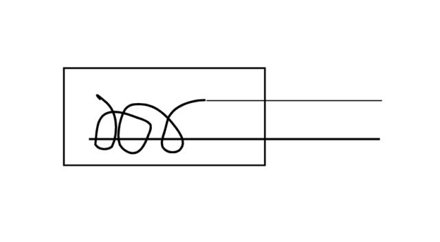

... any hoo, here's a new thread. I have just got a pack of ten of these little switches which might help.. They are formed of two leads leading to a vacuum(?) filled can. One of the leads then forms a very delicate, "wobbly" spring around the other. It seems any significant movement from any direction triggers it sufficiently - bouncy as hell but who cares, you want the signal right?
https://www.ebay.co.uk/itm/10pcs-sw-18020p-electronic-shaking-switch-vibration-sensor-RDD-FH/153302967713?ssPageName=STR K%3AMEBIDX%3AIT&_trksid=p2060353.m2749.l2649
a fag-packet drawing of the innards looks something like this:
