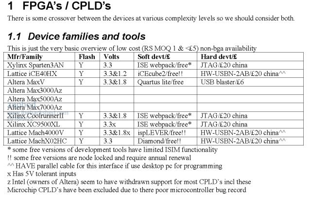

Recently I have been considering replacing some if not all the functionality of micro-controllers with fpga's or cpld's to avoid the ongoing frustration with peripherals that don't do what it say's on the tin, in particular pwm's. My applications are generally low cost and as a toe in the water job I certainly dont want to spend £££ on expensive tools.
If anybody else is thinking of this here is my list of potential devices.
Cheers Roger

In general the problem with micro controller pwm's is when you use the "advanced" features they don't do what they say! For example the Microchip advanced pwm error recovery doesn't work nor does the output override. The STM32 cannot drive half bridges. None of the PIC PWM's can work at a low incremental frequency and rarely have an external clock input and/or it is limited in frequency range and on top of that they generate glitches under certain circumstances. Sadly just about any project I have conceived in the last few years has been hampered by micro controller pwm's not doing what the spec says.
As for your proposed solutions they do not fit my criteria, either being BGA packages or $75++ that I do not consider economic, sorry.
I am sure Arduino may be an adequate solution for many but I have no experience of it, generally I write in assembler and require 10Mips+ with a 1Mhz+ ADC together with as many op-amps and comparators as I can get in the integration (of a single chip) so I may be an isolated case! I have looked at ARM and found the instruction set very slow and to many alternative ways of doing the same thing for sane programming, also the peripheral interface data is scattered and poorly documented, best left for people programming in high level languages using hardware abstraction layers, definitely not for me!
