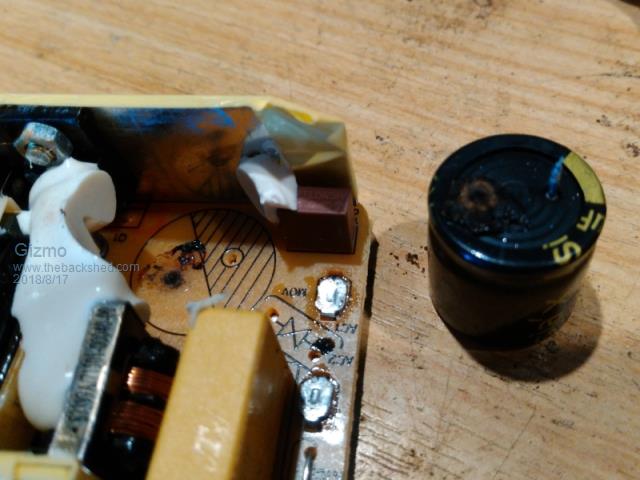

I've noticed over the last few weeks my amplified PC speakers were making a humming noise when I turned the volume down. With the volume at its normal position, there was no noise, but when I answer the phone first thing I do is turn down the PC speakers at its volume control, as I'm usually listening to music or podcast. As I turn down the volume, the hum got louder and louder.
100Hz hum, so I suspected a dry filter cap. I tore down the speakers, and replaced the 6800uF 35v electrolytic, and did the usual check for dry joints, etc. No improvement!
I then discovered if I unplugged the audio cables from the PC, the sound was gone. Was the PC the source. I turned it off, no improvement, so I unplugged its power cord, no improvement. What! Where was the hum coming from? Maybe down a USB cable from a power backup drive? Nope! Network cable? Bingo!

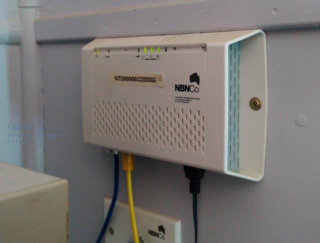

I tuned off the router. Still the hum. I unplugged the network cable to the NBN box. Silence! Must be the NBN Box power supply, its a wall wart type of supply, 12vdc at 2amps. Would be about 5 years old now, and runs all the time.
Google it, seams like everyone stocks NBN power supply replacements, even Jaycar, so they must fail often. I decided to pull mine apart and see if I could fix it. Cracked open the case and I could see the main filter cap had been warm, the glue around it has separated from its case. After desoldering one leg it basically fell out. The other leg had evaporated.
The cap was a Asia'X brand 47uF 400v, 18mm high and 18mm wide. The only one I could find in my collection that would fit was a 22uF 400v cap, that would do for now. I fitted the new cap, filled the gap with some hot glue, and put it back together.
Fixed! No more hum in the PC speakers, and this morning I noticed my bedside clock radio sounded a lot better than is has for a few weeks, no static.
So I wonder if NBN Co should be sending out replacements? I would imagine there would be thousands of similar power supplies of the same age, with the same fault.
GlennEdited by Gizmo 2018-08-18
