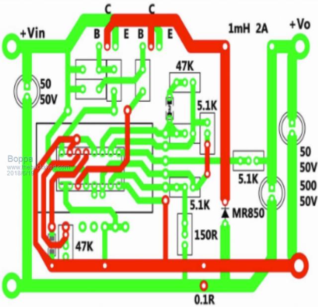

I looked at this thing (no other info forthcoming from the person who 'designed' it)
I cant even follow what its supposed to be doing (if anything)
Any ideas or is it as I suspect pure 'magic happens here'
eta the IC is a KA7500B a smps controller IC
eta2 info on the controller IC available here
https://www.mouser.com/ds/2/149/KA7500B-889308.pdfEdited by Boppa 2018-06-20
hotwater
Joined: 29/08/2017
Posts: 120
Posted: 06:58pm 18 Jun 2018
The question is why would you put any time into it. There are cheap motor controllers for only a couple bucks. This is actually a buck converter power supply using parallel PNP transistors. I wouldn't use that design. What voltage do you want in and out?

Because I suspect that this particular circuit as shown doesnt actually work at all....
I havent actually used this particular IC and my reading of the datasheet says that it isnt supposed to be wired this way, I was wondering if someone had come across anything like it before..

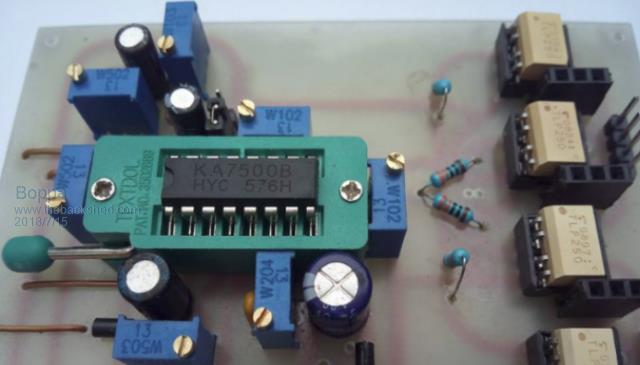

Posts: 816
Posted: 05:16am 15 Jul 2018
Now I'm home, I mentioned before about they put adjustable resisters everywhere, here is the pic I got from them earlier that was on my home computer- a 'twiddle till it works' or just doesnt know what they are doing??
Even the ones that are fixed value in the datasheets I found, they put in adjustable multiturn trimpots- I suppose it is to make it look more 'technical' to non electronics people?
I notice now that their circuit is lifted pretty much from the datasheets for the pcb design, but it isnt the one they actually made up in the photo
