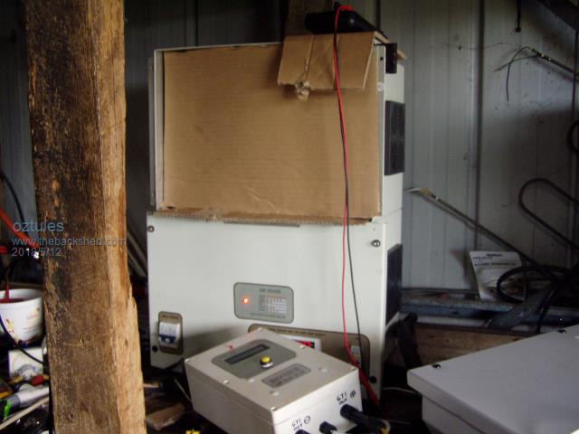

The inverter in question had the usual dual inspire box, where the electronics are in the bottom box, and the tranny in the top one.... but I had run out of lids for some reason I can't explain... so only the control box had a front to it.
The boxes are joined together, but there is a slot about 25mm wide most of the way between the boxes. This allows for the cables from the heat sinks to the transformer a tidy ingress and egress between the boxes.

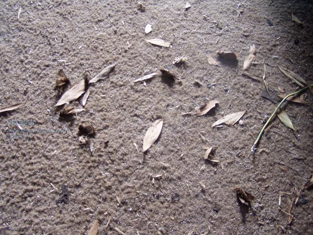

There was no wild life in the tranny box, but when I opened the bottom box front panel, there were hundreds of huge moths, and some little ones too, filling the box. It looked more like a bee hive full of huge bees.... and somewhere under all that pile of insects, was the control and power board.
Here are some of the lads that did not make their way out of the box under their own power
The unit was flashing 2 pulses, to say over current.
10 minutes later, after flushing out the marauding hoard, I found the control and power card again. This flushing was best done having the torch a few feet away, and they all made a bee-line to it... out of the box at least.
So I gingerly pressed the reset, and it came back to life straight away.... so I did not get to see a new reason for them to fail.... apart from little feet all over the control card.
They must have placed a low resistance across the chip pins somewhere, and it interpreted it as a current fault... thank goodness it turned off before they excreted anything potent on the card, and caused a real malfunction... a spider did this to my first W7 unit... and thats what started this journey in the first place.
So having pressed the reset, I quickly fashioned a cardboard cover to keep the blighters out, and it is still running the house this morning as if nothing happened.
I also have a shed full of homeless moths, which I hope bugger off, as they make a loud noise when they smack into the galv walls.. and annoy me when working out there.
So thats it, still no real failures, except for my shoddy uncompleted facia panel.
So... beware... wild life needs to be excluded from these things. In all the others, they have proper fronts, with weather seals.... but not this one for the last few months. This is just another spare having a few months burn in.
