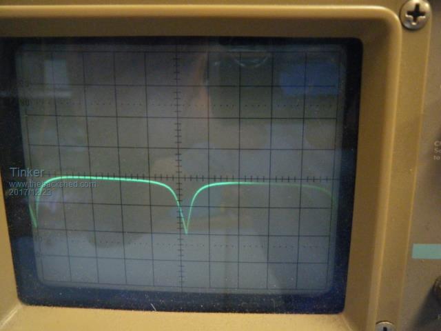

This is with 10A peak current, as measured with my hall effect device:

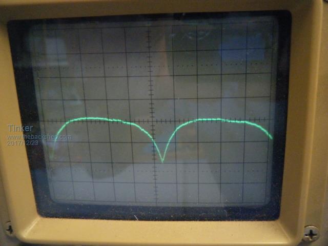

I then wound it up to 50A peak, with the core growling happily:
For the 10A test the input voltage was 40V and for the 50A it was 50V.
Lower test currents just lowered the flat bit on top, the dips stayed the same shape.
I did not dare to push for higher currents as the 50V already stressed my big tank capacitor (rated 40V).
Is that what I should expect or am I doing something wrong?
I am just curious when this core saturates with the original winding and what effect another 30 turns would have
But I need to know if and where on that curve saturation occurs?
Thanks for your suggestions.

Testing these is somewhat difficult because of the very high permiability and lack of an air gap. Its really an ac inductor not a dc choke.
If its driven to saturation and the current is then switched off, the remnant flux in the core does not fall back to zero. It remains magnetized permanantly and at a fairly high level.
If you again try to drive it to saturation in the same direction it takes remarkably little current to again saturate it.
If you want to see the saturation curve, it would need to be fed with a square wave voltage that was ac, or alternated in opposite directions. So a very different type of tester would be required.

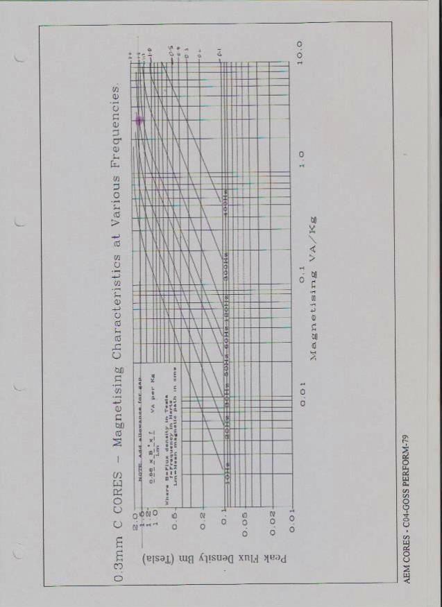

Anyhow, here is the magnetization curve for 0.3mm grain oriented silicon steel strip, which is what our toroids are wound from. Its a bit difficult to see, but what we should be looking at is only the 50 Hz curve.
The vertical axis is the flux density, and the horizontal axis is the magnetizing power, shown as Va's per Kg of core material.
You will see a pink fuzzy dot on the 50Hz curve, at 1.5 Teslas which is where many commercial transformers are designed to run.
Notice at higher flux densities the curve goes horizontal. The magnetizing current rises to infinity as the flux goes much higher, indicating complete saturation.
If we drop back to lower flux densities say around one Tesla we reach about 1Va per Kg of magnetizing power, and we are into the linear part of the 50Hz curve.
