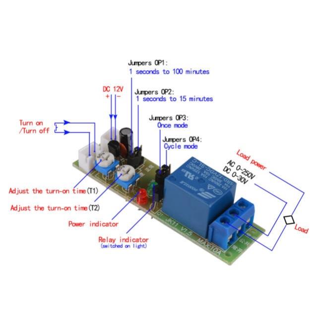

There are little electronic Multi function boards on flea bay that do this. They are in fact latching.
Some have displays, some don't but all you would have to do is wire a second little push button to start switch to a panel with the board in a box and you would be fine.
Look for Trigger Cycle timer. There are some variation but this is the sort of thing you want. You can set you cycle for 12 hours 6 or whatever you want.

Look at this. It appears to have many settings up to 24 hours, at 5 / 12 / 24 volt types . . . $3.25 + ship
