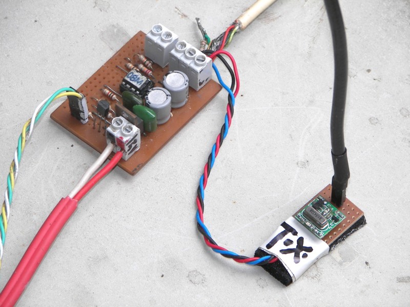

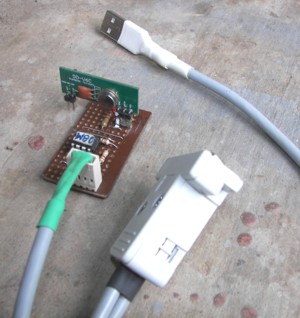

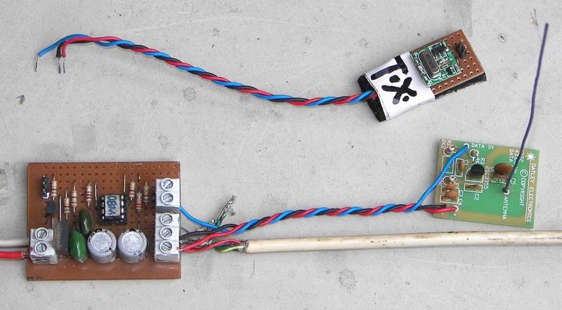

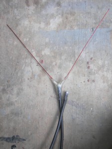

Here's some pics of my anemometer test units.
Anemometer with TX Module
PC Receiver with RX Module ..............................Antenna, coax n socket
and here's 2008-01-14_205428_Anemometer__remote_logging.zip of the codes and circuits used.

I connected up the more expensive K122 transmitter and RX-14 receiver today and with the now correct software they are firring like a dragon too.
As a 'why not' experiment I ran the TX434A transmitter into the RX-14 receiver and was very surprised to find I was logging data. About 3/4 got through which is more than I'd have thought possible.
Finding that a surprise, I just had to connect the TX434A transmitter with the PVJ6WC ( GD-V6C ) receiver. Even more surprised, it worked perfectly. Walked all around the camp up to 150 meters and even with building obstructions it never faltered logging correctly. So most impressed with it all. Well within my intended range of use for sure.

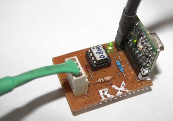

Here's the unit I got working today:
Anemometer & K122 with TX434A close by
PC Receiver using RX-14

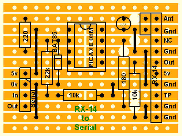

stripboard layout

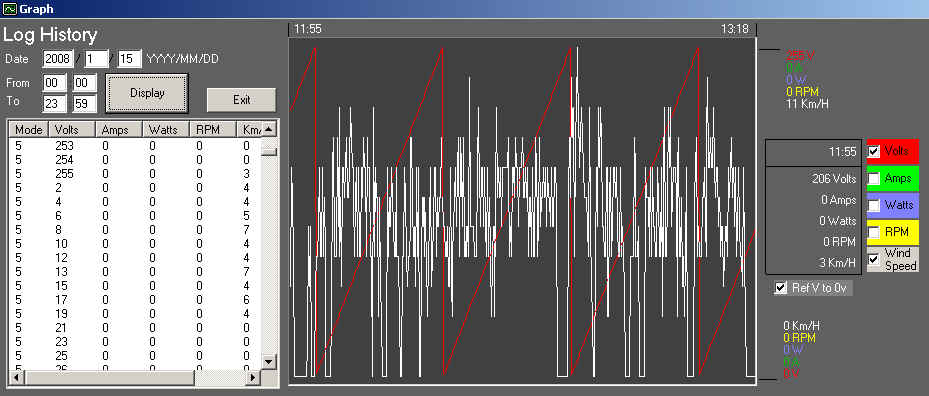

Graph of Anemometer readout using Gizmo's PicLog.exe
I like charting the 'line count' (shown as volts) as it is very easy to see if data has failed to get through but I get a perfect sawtooth every time.
Gizmo, Can we decrease the graphing interval below 10 seconds on this software?Edited by Gill 2008-01-16
