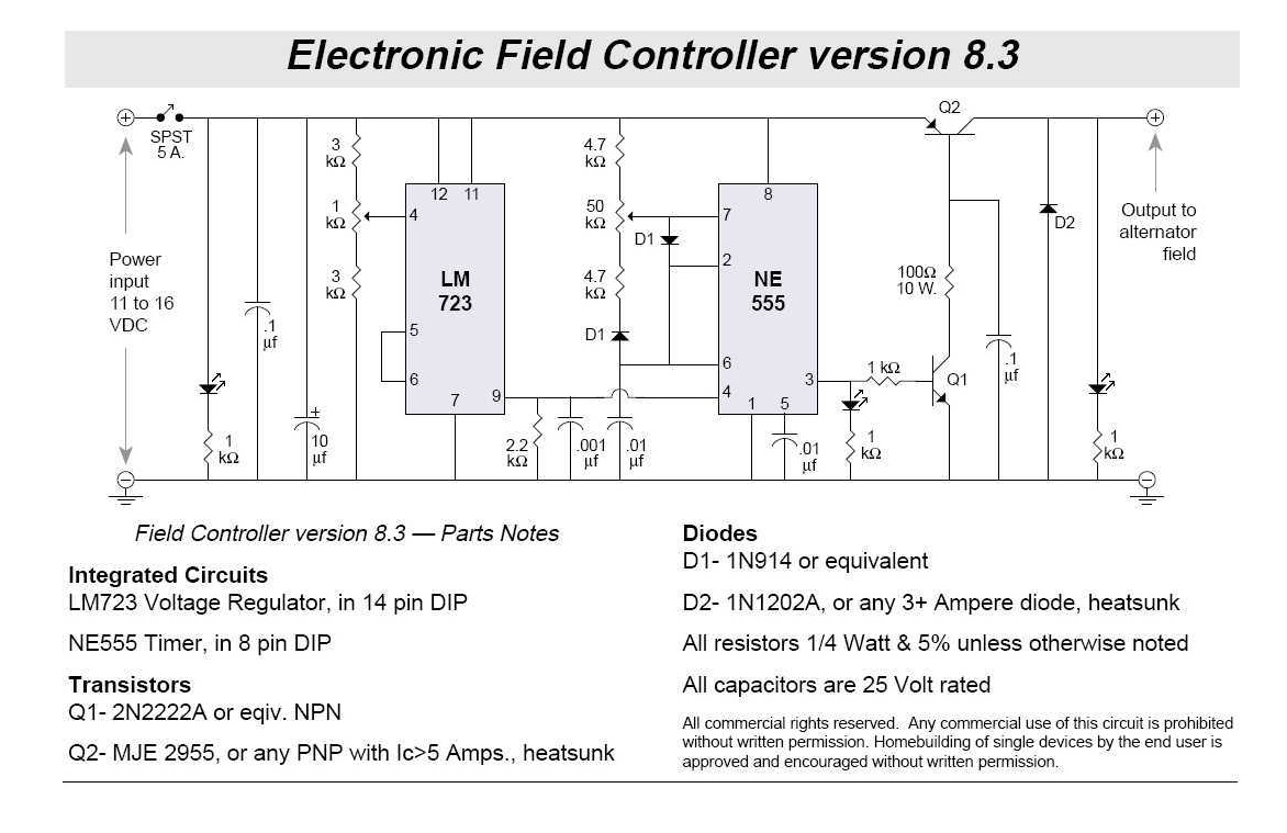

Posted: 08:50am 15 Sep 2007
Roy, this a 12 volt version
from an article by Richard Perez 1994 in Homepower mag
Being mechanical and just dabbling at getting zapped,
I expect that the capacitors need to be 50 - 60 volt range.
The 3K and 4.7K resistors need to be sized for the higher voltage.
And Q2 might need to be stronger.
We need a voltage 27-33 volts
I hope that some electrical buff might be able to point us in the right direction.
Kevin

sawtron1
Joined: 10/03/2007
Location:
Posts: 12
Posted: 12:28pm 15 Sep 2007
Kevin,
Thanks for the Info, I ahve a friend who dabbles in electronics, will show him the diagram and post you a reply when I have some info,
Thanks for your effort,
