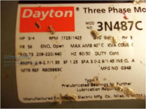

Bryan, I have been considering doing a hybrid induction permanent magnet generator using a 3 phase 3/4 Dayton? It is one of the 9 lead triple voltage 208, 240, 415 motors being I am here in the USA. It is a 1800 RPM unit and I am just wondering if you think it would work? What kind of output can I expect maybe? I do not have the resources for rewinding or machining of the rotor so I want to use this method http://research.ee.sun.ac.za/emr/files/u1/Paper29JHJPotgiete r.pdf

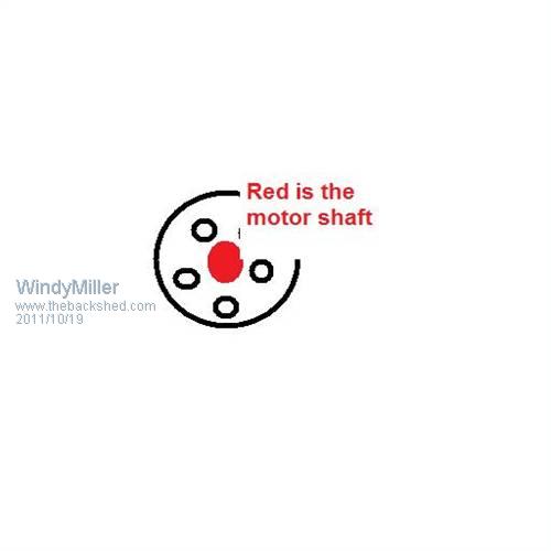

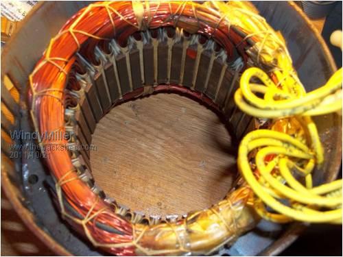

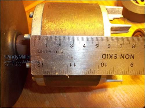

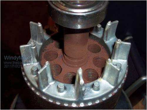

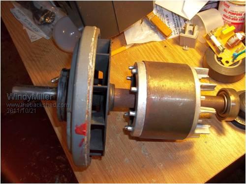

GidDay Everyone! I have decided to post some pictures of the motor I am working with in the hopes that what I am trying to do becomes clear? The two links above are the core of what I am trying to do. This link PMIG is the one I am using the most as it shows the PMIG stator and the flux fields. I just don't see why putting round bar magnets in the holes seen in the rotor would not energize the machine enough to start it generating and then use the normal cap method for full power from the machine? Should it not cause the unit to start generating at the slower speeds?
