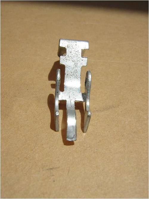

The other thing I found from disassembling several breakers is the contacts are all the same regardless of the rated amperage stamped on the breaker and the amps only relates to the circuit breaker that we don’t want to use anyway.
In short..... a 10 amp rated breaker has the same contacts as a 80 amp breaker, so any will work well for a mill.

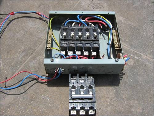

The other nice thing with these switches is they have large wire terminals and are all able to be mounted neatly on a din rail within an enclosure.
My lot costed $10.00 with the enclosure included. (several not shown)

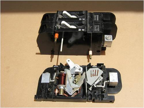

Separate each of the 3 breakers so they are 3 single breakers.
Drill the heads off the 4 brass rivets holding each of the 2 switch halves together.
Press the rivets out slightly and then drill the bakelite housing a fraction deeper to allow for the rivet to be reused and re-riveted again.
Part the 2 halves of the switch gently.

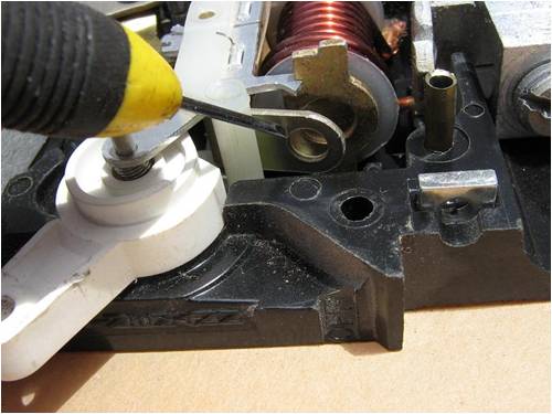

Move the switch to the closed position and then press down on the plate over the end of the coil, while watching the trip mechanism within the switch.
Magnet plate over coil.
Trip Mechanism lever in switch

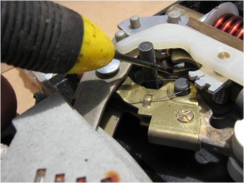

This is what the mechanism looks like, and it’s the little curved lever at the bottom than needs to be bent back.
With a screwdriver gently bend the mechanism back within the switch without removing it, then closed the switch again and try pressing down the plate over the coil, this time the switch should stay latched and not trip as it did previous
Modification done and now just need to assemble the switch again and fix the rivets.
