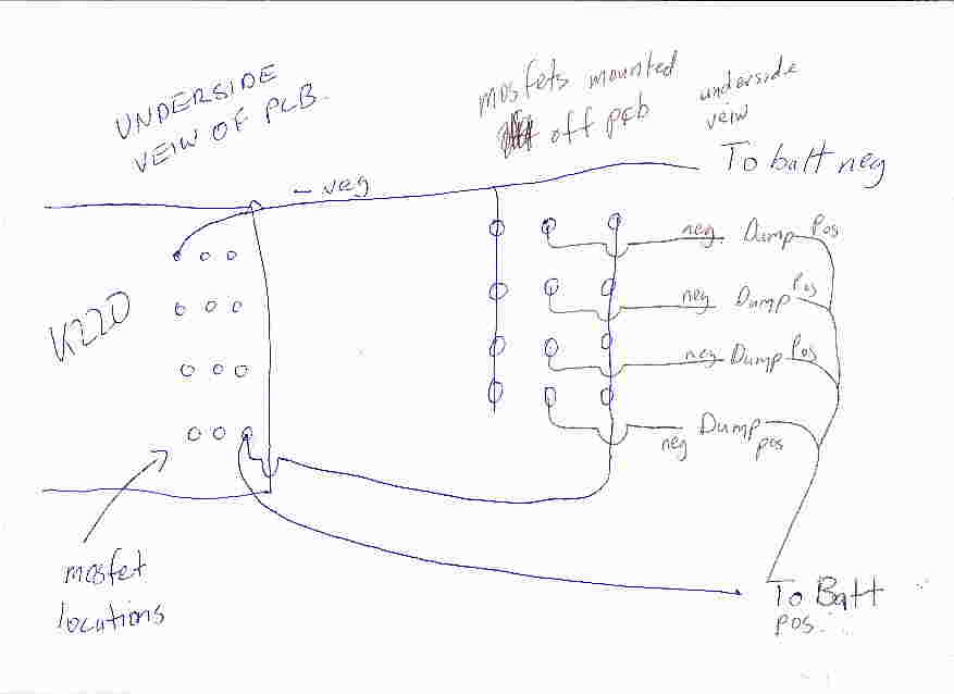

G'day guys,
electronics are my weak point so can you help me a little?
With a the k220 the directions are to connect the mill direct to the batteries and run the shunt reg off the batteries.
Does this mean that there is a constant load on the mill?
Or does it only cause a load when the mill reaches the same or higher voltage of the batteries?
I'm guessing the second option.
Also I posted a question regarding off board wiring for mosfets in the general page but only glen replied.
He said it looks like my drawing was right.
Can anyone who has a k220 confirm this?

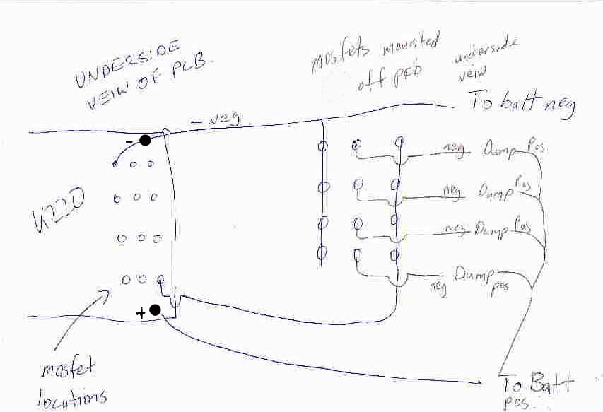

Sorry old mate, not quite right. Check out the corrected sketch. Mosfet Gate and Battery + have seperate connections. ( Though I recon you'd have picked up the error when wireing up. )

Gill, excellent!
Thanks for the help mate, electronics are definately not my forte. Can't see the pic, I tried to upload one before with no luck, maybe problem at the server.
I'll have another look later.
