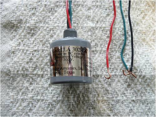

Interested in lighting protection. I have an extra lighting arrestor for one of my PV arrays that I would like to use for my mill. The wiring is relatively easy for a PV system red postive, black negative, green ground. Normally this arrestor would be mounted at or near the PV array, just wondering if I can use it on my mill. I do charge a 48 volt battery system.
Pictures are not that great,
Specs are
Delta LA 302-DC Max voltage 500v.
Cant help thinking that if I wire the arrestor at the battery end of things by the time a lighting strike hits any and every thing from the mill to the battery will be gone.
In case your wondering no I haven't grounded my mill with a ground rod at the base of the tower. Ground is frozen at this time of year.

I have a three-phase arrestor from Delta. I have spoken with the company in the past, and each lead is connected to a variant of a MOV (metal oxide varistor) which conducts once a critical voltage is reached. Each lead is connected to each phase, with the ground going to an 8' copper rod. I have two of my four tower guys connected to an 8' grounding rod. My tower pole is connected to an 8' grounding rod.
