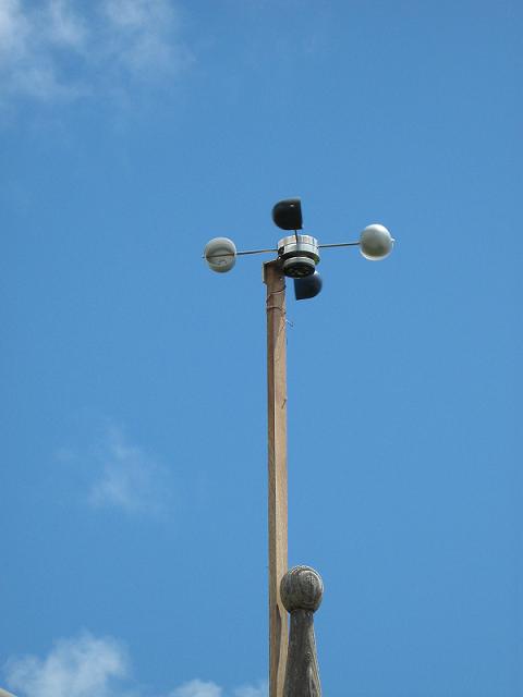

The anemometer i am doing at present is using a optical sensor out of the gutted video but im not sure on the expected life of a optical sensor out in the elements of nature.

Heres a shot of the video head one on its first test flight to see how it spun and data rate etc.
It has barely stopped sinse its been up and always moving even is ever so slow.
Great bearings in video heads.

Posted: 02:17am 10 Dec 2009
Hi Pete
That looks the part to me better than those fragile plastic ones marketed on ebay and jaycar.
It looks like if it had a skirt with holes drilled around it with the sensor underneath it would last a long time, I used one of these sensors in a ignition system and it never gave any trouble even it adverse conditions under the bonnet.
When the thing is spinning it would keep water out by centrifical force.
Led could be powered by battery with solar garden light innards, plenty of those around cheap or give away when the origional battery dies.

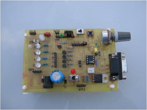

Posted: 08:46am 11 Dec 2009
Bob,
Download picaxe programming editor from HERE as it is what is used to program a picaxe with.
It is Free to download.
Once downloaded go to the help section up the top.
You will find all the programming instructions and examples in the help section, there is also project examples and more.
You will not find much more information in a book than is already listed in the help.
The 2 main chips of interest in the picaxe range is the 08M and the 18X although they all program the same but some have different functions built in to others.
What i would prefer to do is have yourself and any one else who would like to be involved to purchase a 08M picaxe and a few leds etc and set up a small test board on some bread board or pcb and have a play and learn how to turn a led on and off in program and then move to another step and so on just to get a feel for basic programming.
I think it is fair to say we all started with leds etc and advanced from there.
One is kidding themselves if they think they can jump straight into advanced programming.
Learn a few basics and the rest gets easy quickly if you have someone to ask when you get stuck.
I would be happy to guide you and others through getting started either via the 4m or direct email
Would yourself or anyone else be interested in a GETTING STARTED with programming project.
From small things big things grow.
I designed a prototyping board for the 08m when i started to play with them so i could test a program and learn how these thing worked that i still use today when developing a idea.
You dont need to go to the extent i did but with this board i can use all the functions the 08m has available.
Pete.
