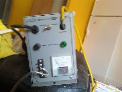

This one was inside the head-end (where the video processing/encoding happens). It steps 110AC to either 30 or 60V AC with a 20 amp AC amp readout on the front.

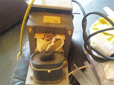

Here's a shot of the large/heavy transformer

Might be good as fill in the concrete for the tower base, boat anchor, etc. LOL.
There may be uses, but these seem to be old style 60Hz iron cored transformer types. Not even heavy duty rectifiers or extruded aluminium heatsinks.
If there were 3 identical units, these may be suitable for AC coupling a high voltage windmill to a battery.
