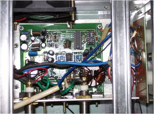

Hey I'm wondering if anyone can shed some light on the operation of those cheap Chinese windmill ( the ones with the noisy fibreglass blades ) controllers. I know the controller is pretty unreliable and dont last very long, but I was wondering how they regulate the output. Is it a shunt controller? If anyone has a pic of the cct board that would help.

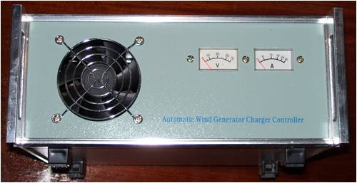

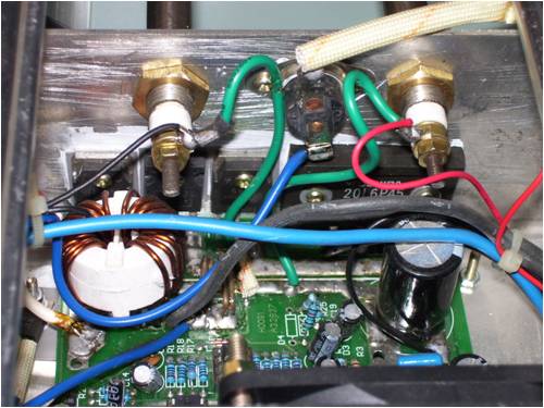

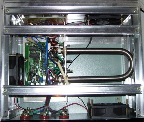

ok, lousy shots, sorry, but here goes. If you want more detail, let me know and I'll try to take some better shots when I have better light....

Thanks for the photos Ross.
I've got one of those circuit boards, minus the bridge rectifier. I think Dennis gave it to me, it was broken. I didn't know it was used for.
The dump resistor is 3 ohms. There's a micro chip, MOSFET driver ic, an awlfull lot of parts for a simple controller.
