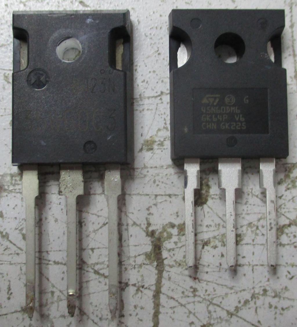

New parts arrived - legs are shorter then the original, so won't fit!
I never noticed that in the datasheet....

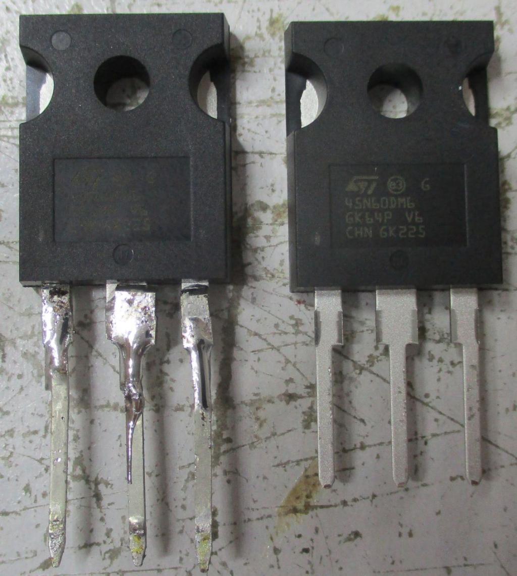

However, I have cut the legs off the old MOSFETS, and sweat-soldered them on to the legs of the new parts(after trimming them a little), so that the legs are now long enough to poke through the PCB and can be soldered.  I THINK that will work OK.  Full anti-static precautions used during this mod, and also during the install back in the PCB.
The only thing that worries me A LITTLE, is if the legs of the transistor heat up enough to melt the solder and it dribbles off, but I DON'T THINK that will happen, cos the new devices are rated to 160'C, but even that is not hot enough to melt solder, so I THINK I'll be OK.....

  Quote  if the legs of the transistor heat up enough to melt the solder and it dribbles off
That is a good thing! They can only get that hot after they have died.
