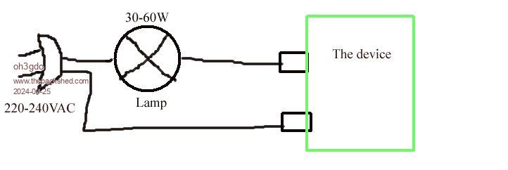

I do not know how your  Ozinverter works, but i think it works with 220-240VC,
To limit the current, you must limit the voltage.
How much?
I do not know, but if you put normal or led lamp with the series of power, it doesn't burn the whole device.
Then when the lamp is lighting start to measure all power supply circuits.
The voltages are much smaller than normally, but is something 0V?

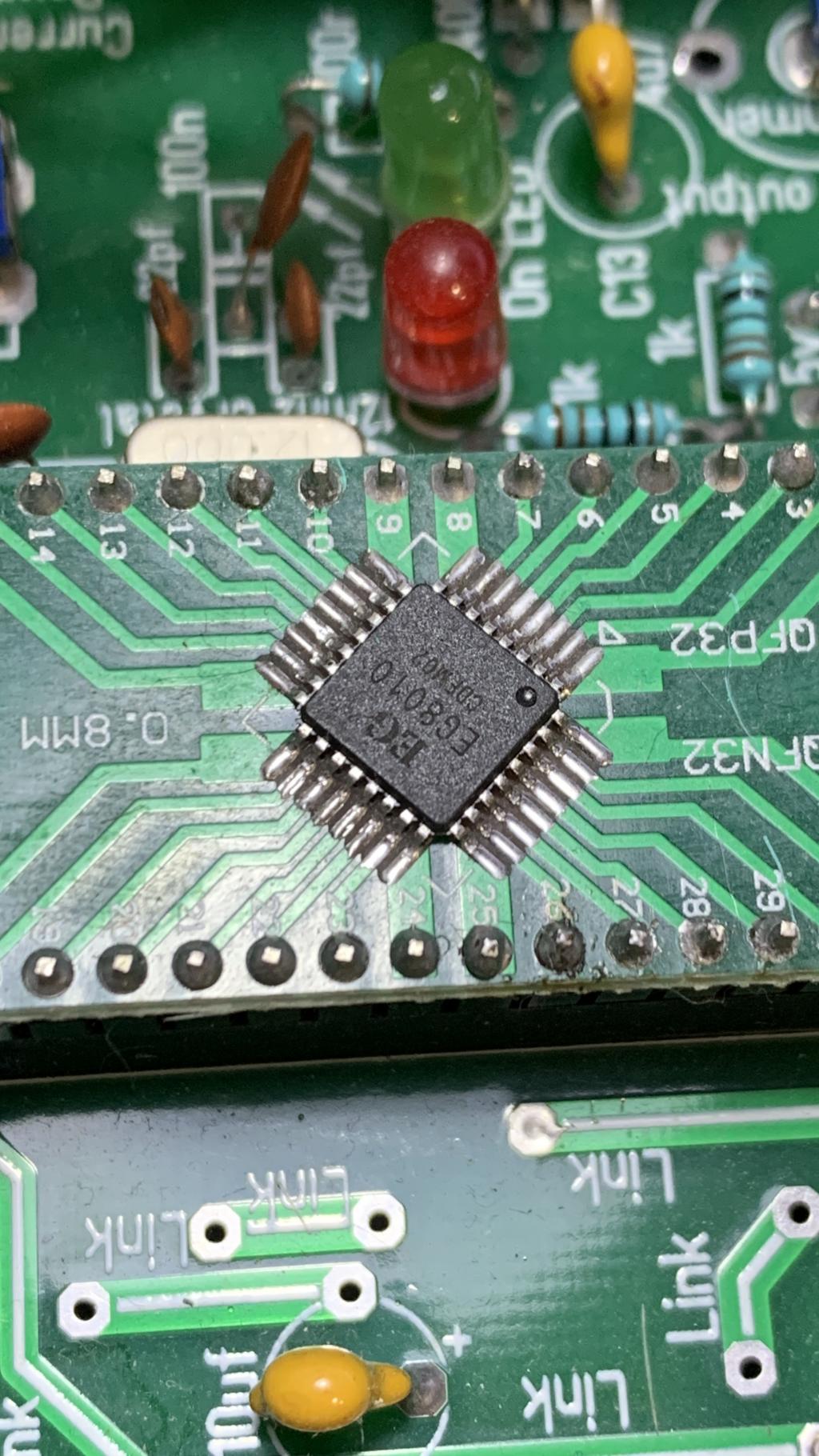

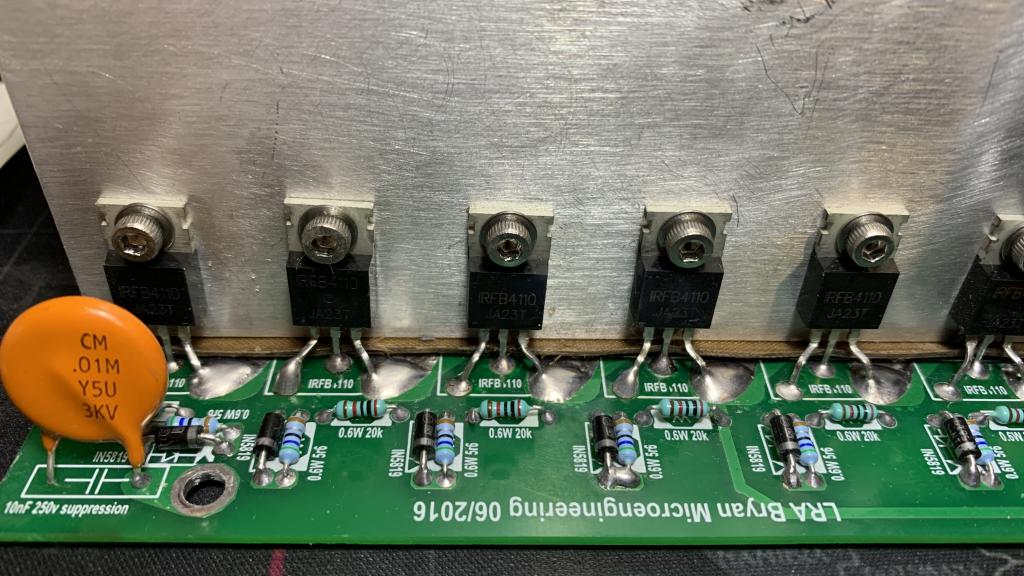

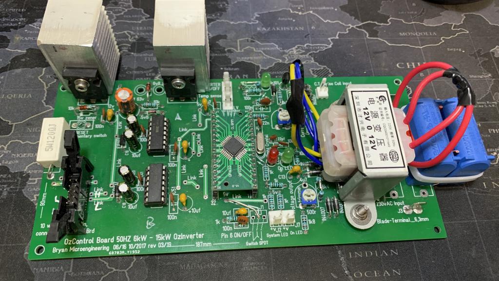

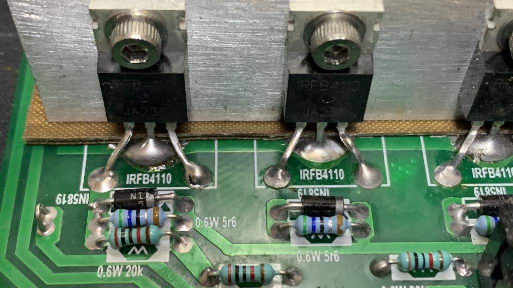

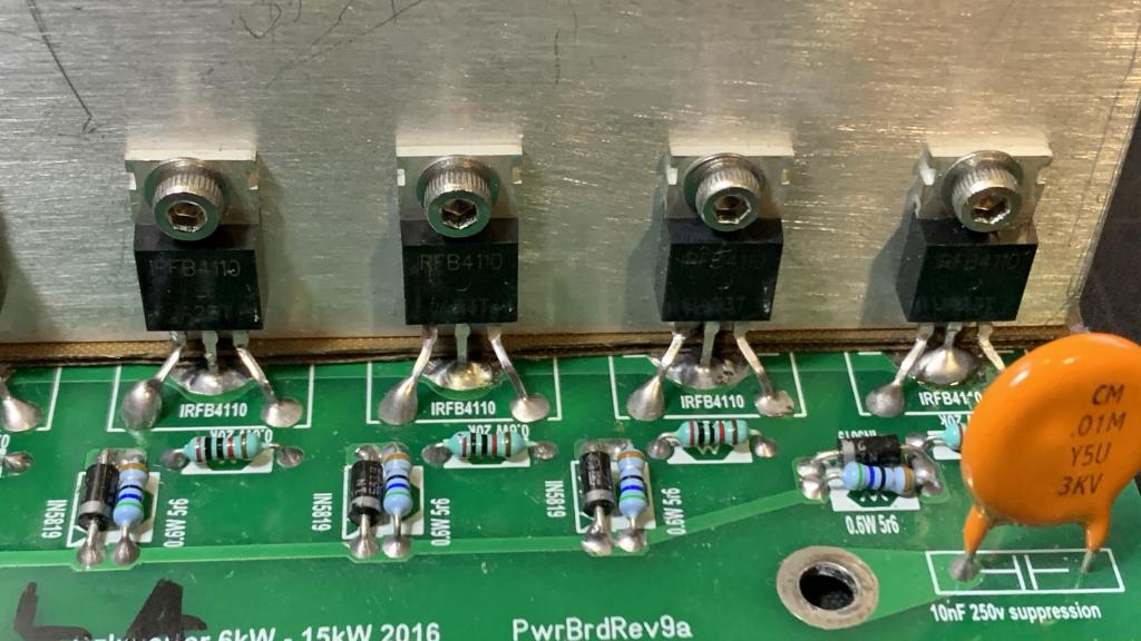

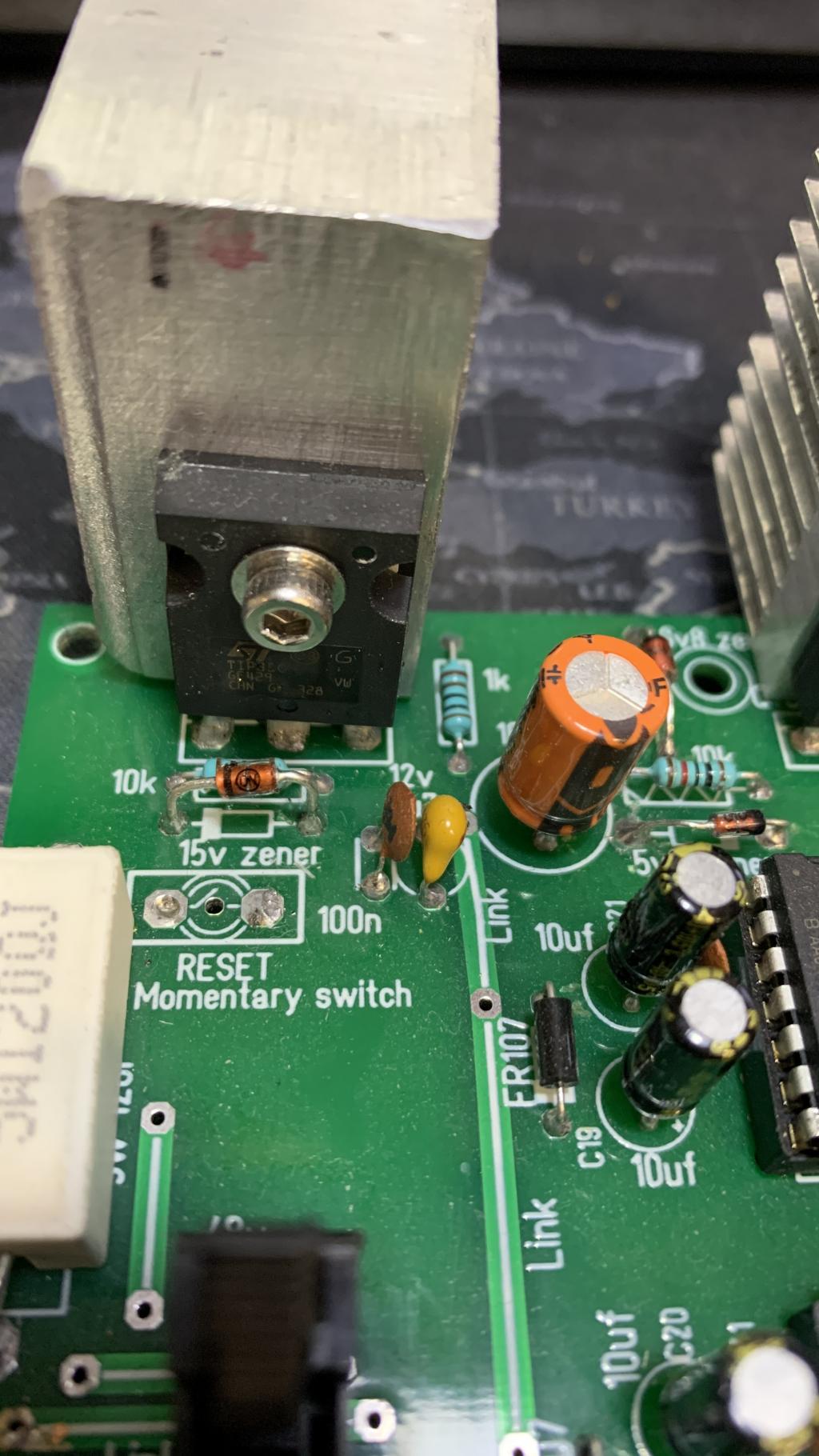

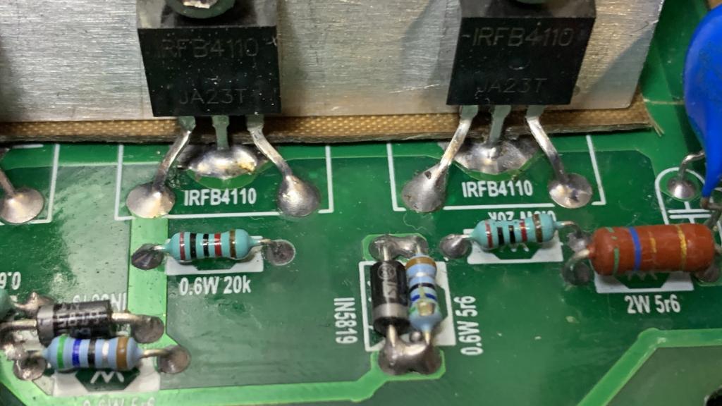

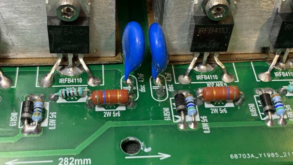

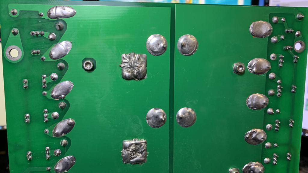

I would start with posting pictures of your pcb's to see the quality of your solderwork.
Second where did you obtain your components from? In my view and others experiences you should not order them directly from china (aliex,....) Farnell, mouser, tme, digikey, etc... are the places to go.
I've build the ozz inverter myself and it's still up after powering up around 5y ago. But all components are genuine.
Only blew 4 MOSFETs and driver because of a short connection when probing with my oscilloscope, but I have a solid electronics background and should have know better.
Start with probing all voltage rails first. Populate only 4 MOSFETs, use a resistor instead of the transformer. That way you can test without blowing things up. After a blow up you can't 100% trust everything with a bit of silicon in.
We will guide you thru the process, I should reread the manual but I thought there was enough guidance in it

I will post the picures in a moment.
Many came from the rs-online.com but eg8010, 24 mosfets and the big caps are from ali.
Ok, I will do that thanks.  What kind of resistor would you say I should use? What about ac voltage feedback? Will the control board still work or maybe I could put 12v on the output of the feedback transformer?

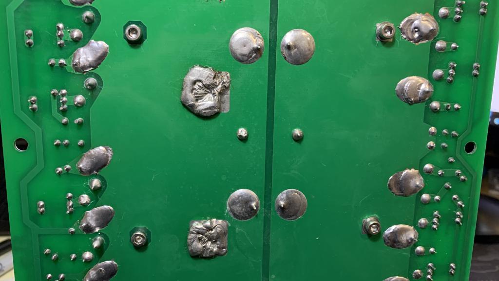

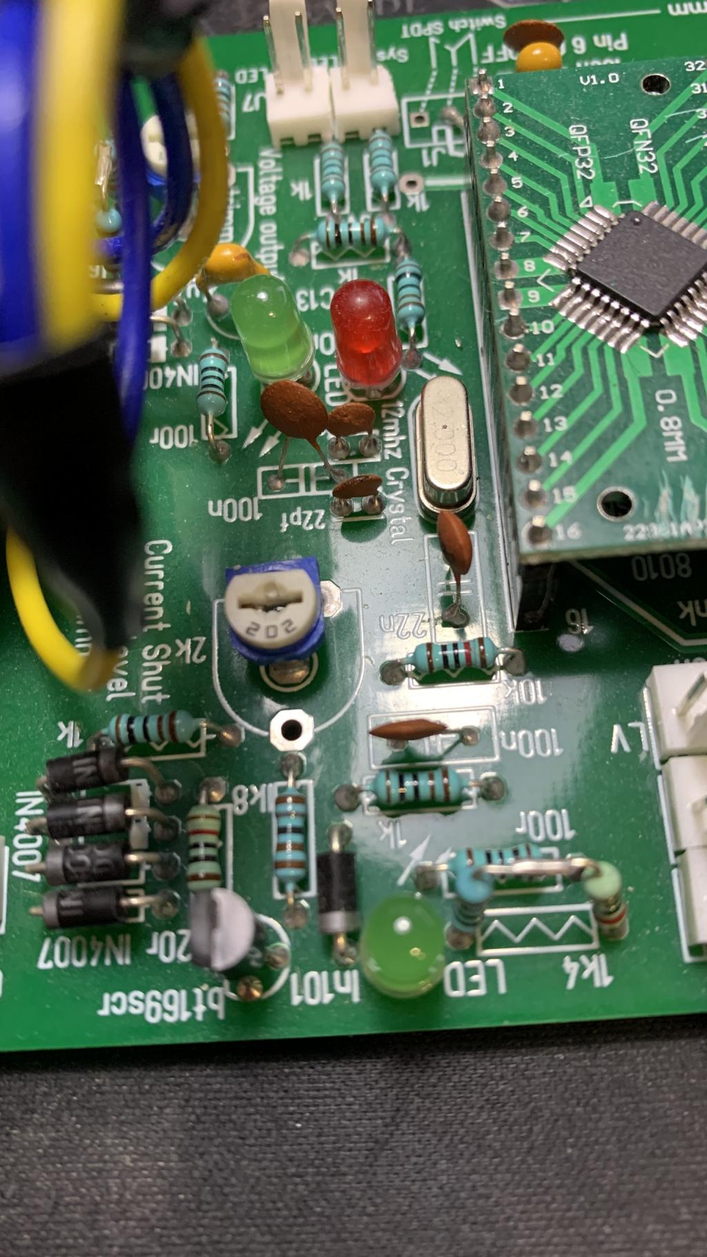

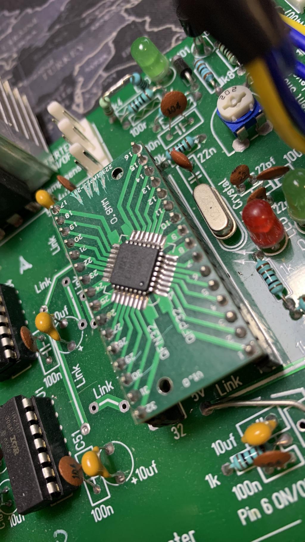

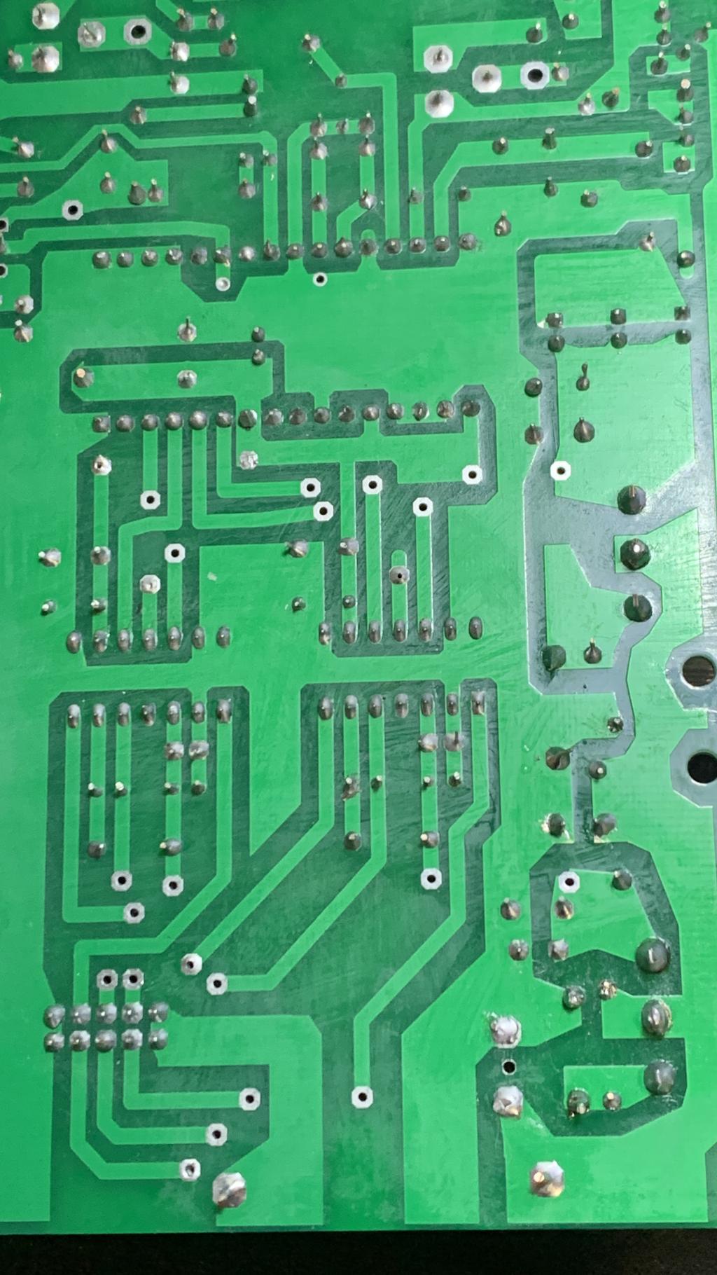

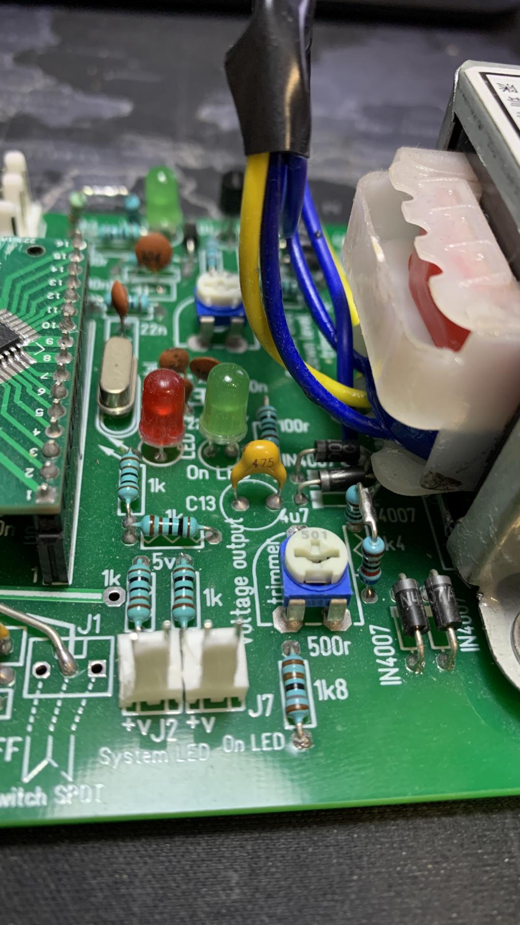

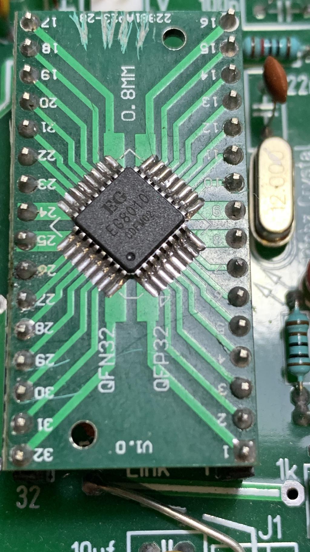

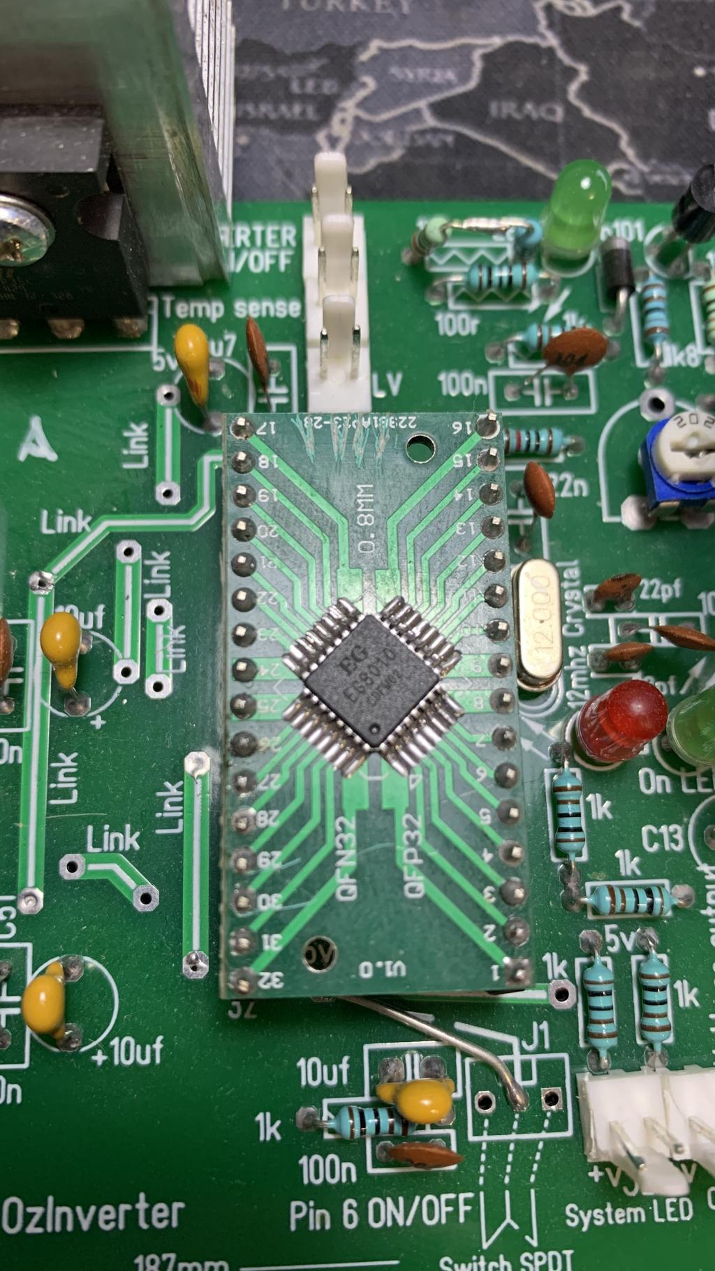

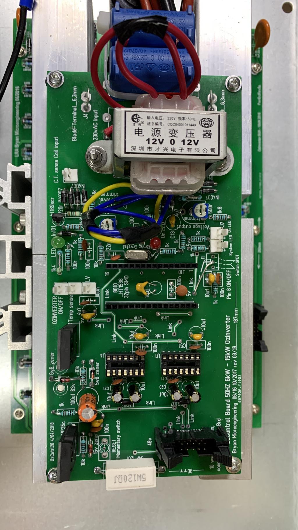

some picures of my build
power board to follow

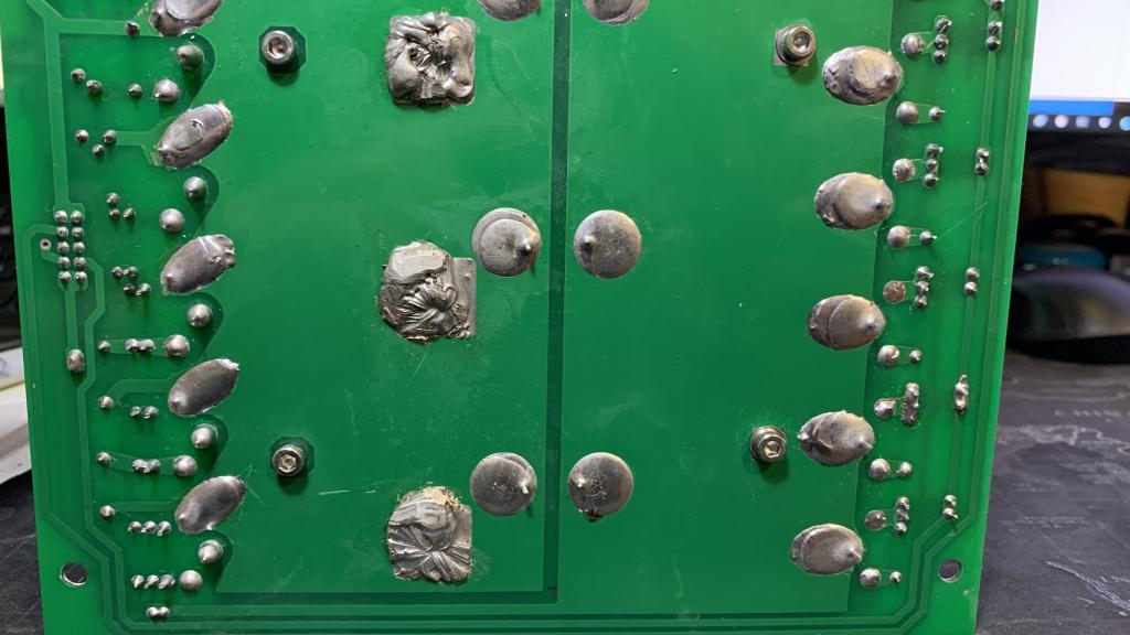

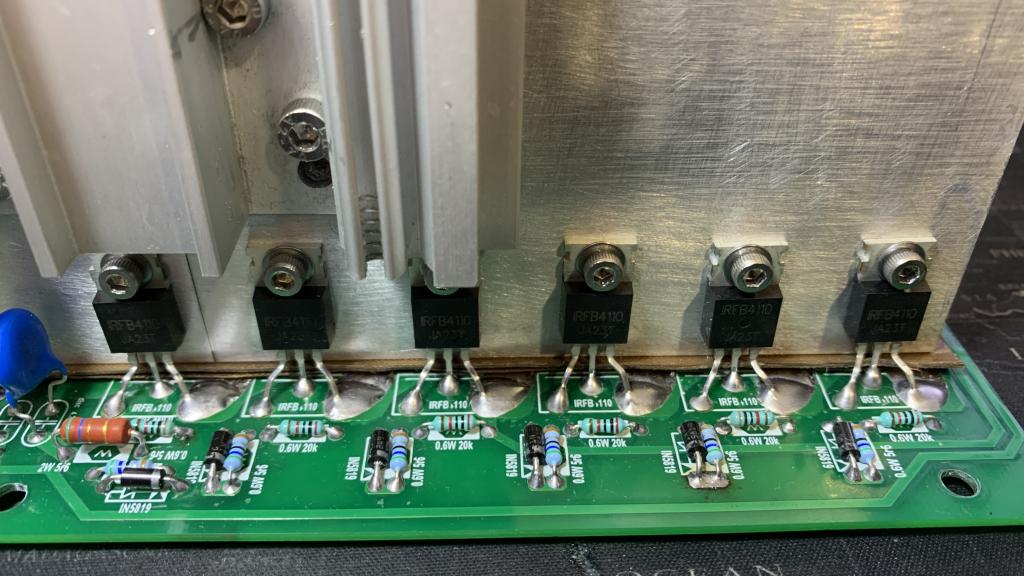

jakesea
Joined: 30/09/2023
Posts: 25

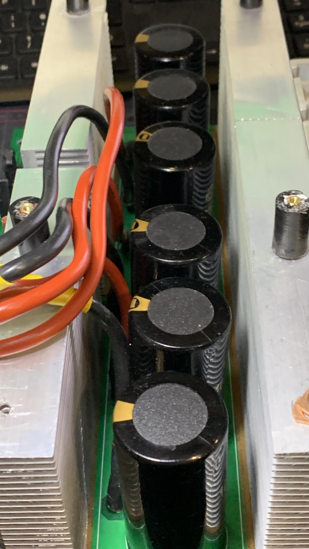

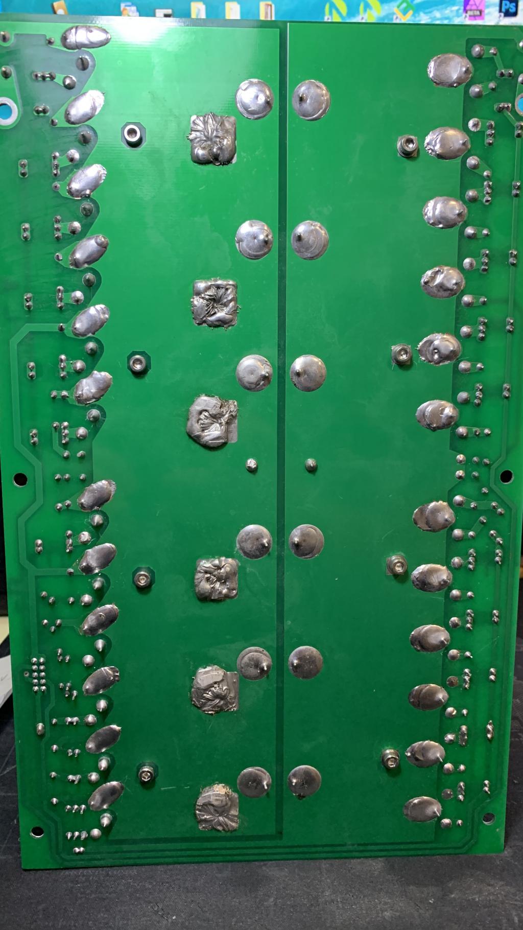

Posted: 11:08am 25 Apr 2024

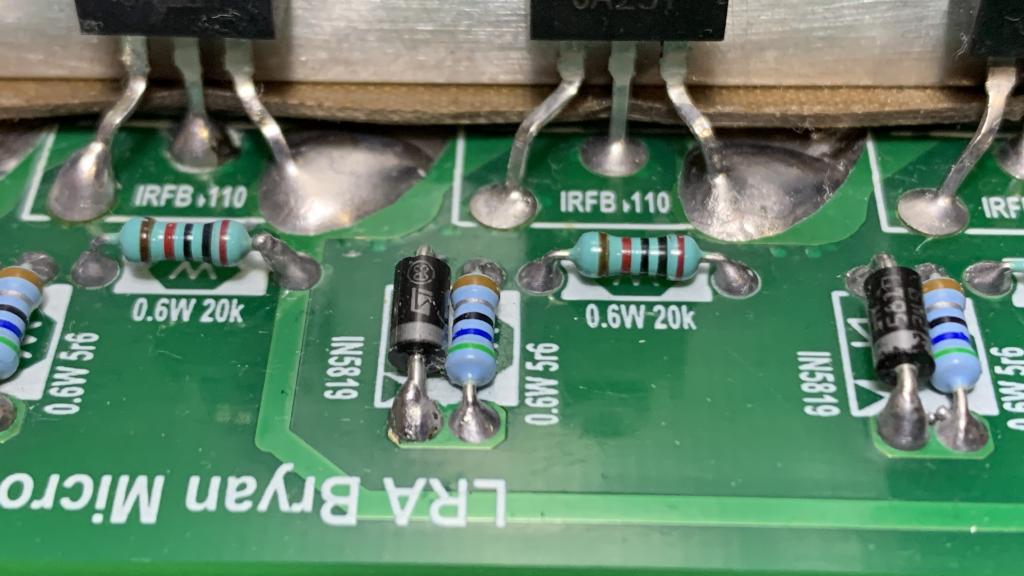

the power board pics

Posted: 08:29pm 25 Apr 2024
Nice work, looks very neat, I'm sorry it blew up.
A 1K resistor might do the trick, it's just to bleed some energy off the parasitic capacitances in the circuit.
I would also inspect the ribbon cable again to make sure it is the right way.

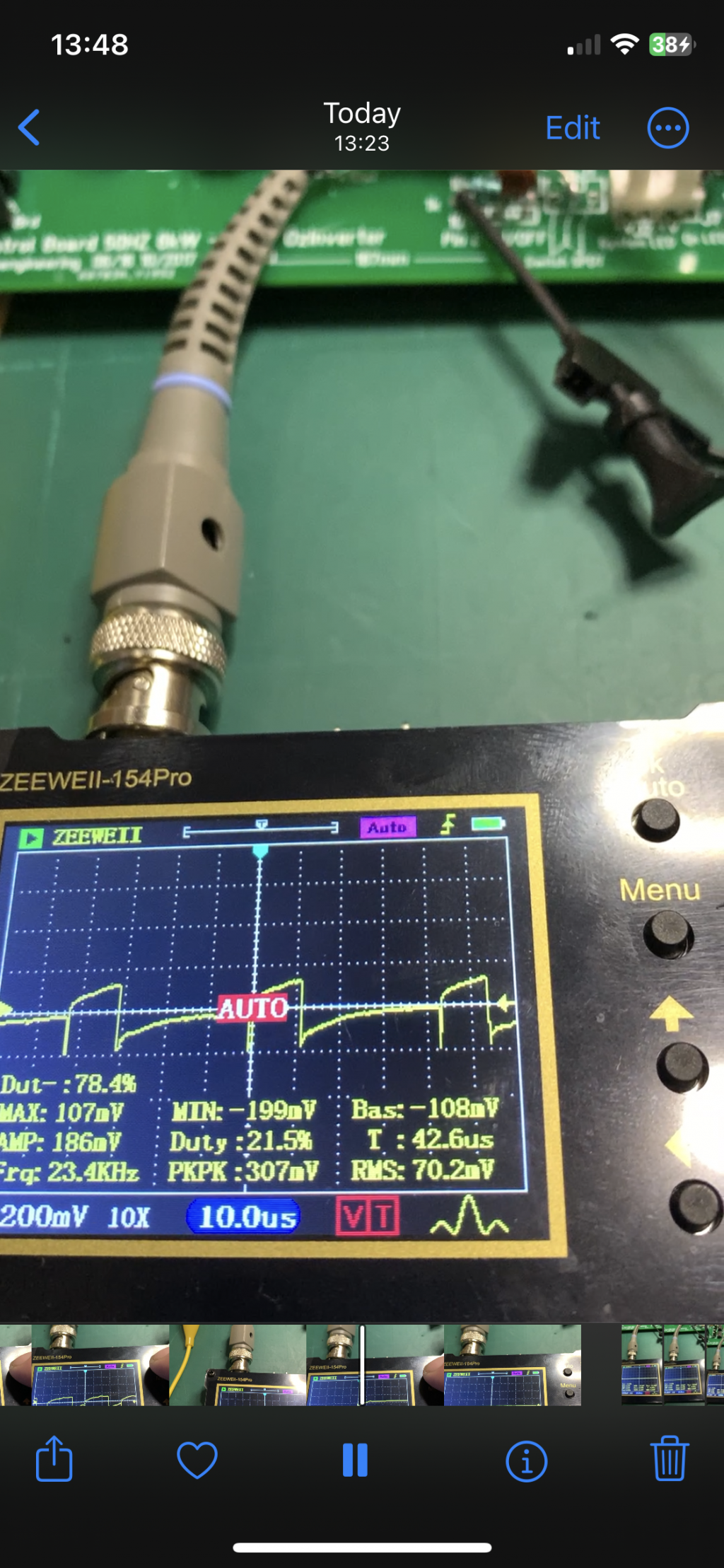

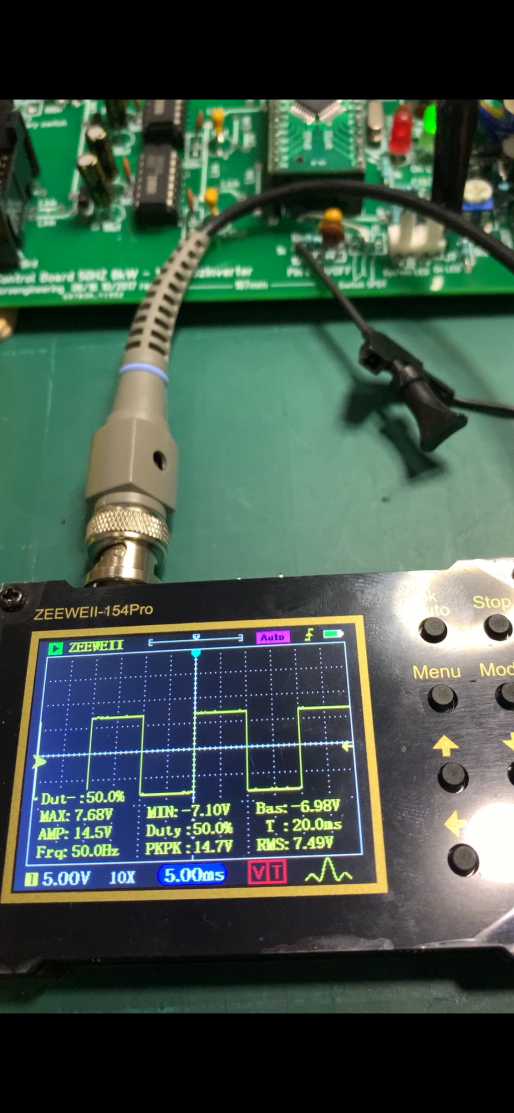

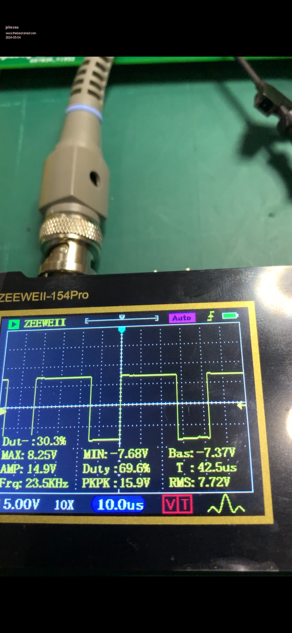

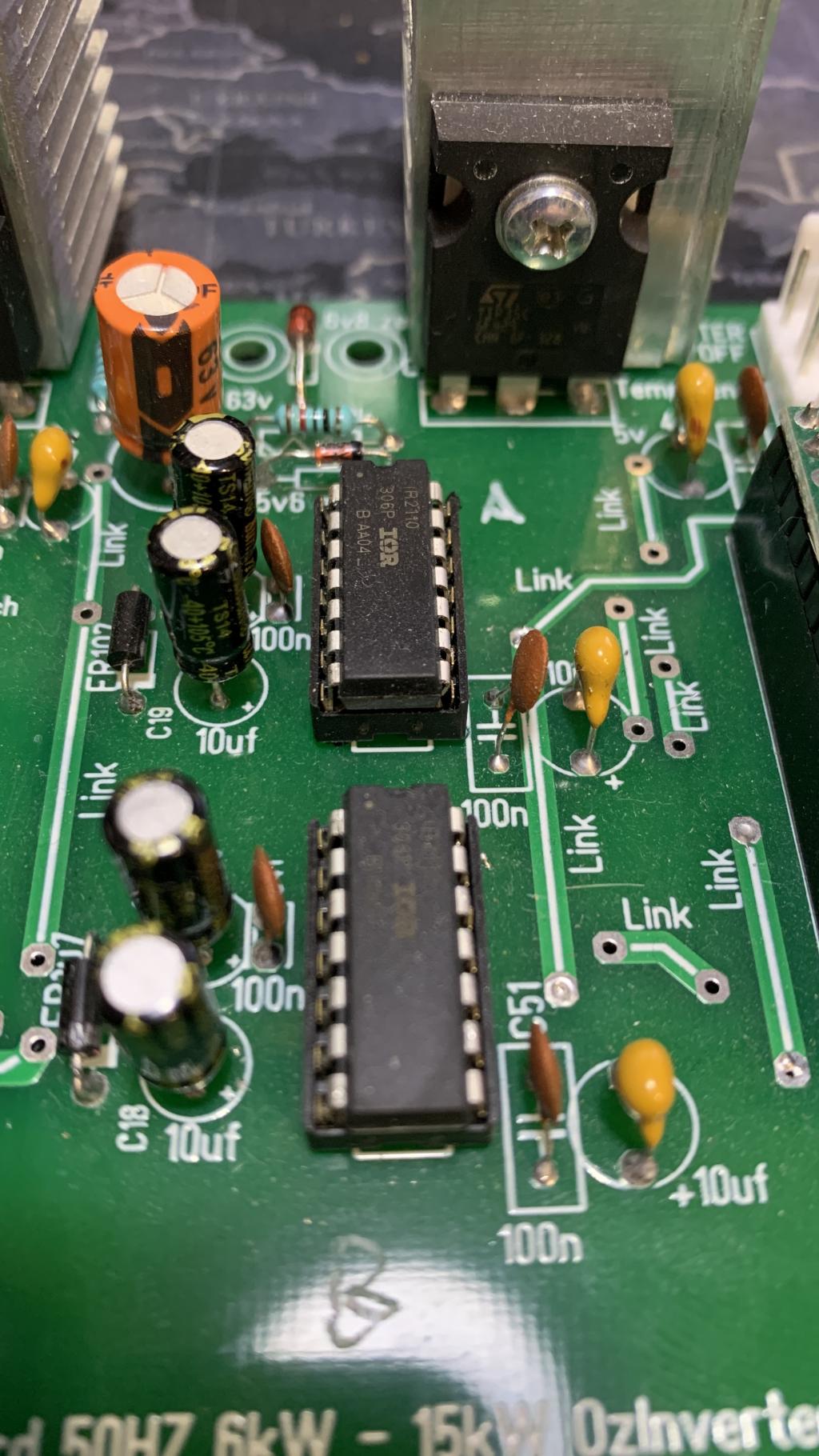

Finally I was able to come back to the inverter after a few days wait for new components to arrive and two days of unsoldering, cleaning, checking...
So, I have replaced both TIP35, three zener diodes just to be sure (15v, 6.8v, 5.6v) and both ir2110 drivers (these two were faulty for sure and I also have ir2010 in reserve). I left current eg8010 for now but I have new ones ready to go in if necessary.
I have checked:
ribbon cable for continuity and correct position
connected to power supply 48v restricted to 1A just for an initial power board check
voltage on one tip35 and on VCC of ir2110 is 14.56v
voltage on the second tip35 and reference voltage on pin 17 of eg8010 is 4.88v
frequency on pins 10 and 11 is 12MHz

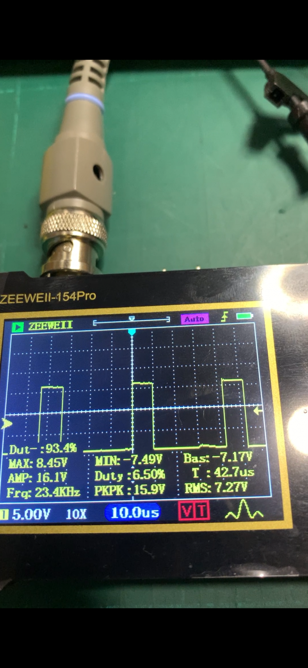

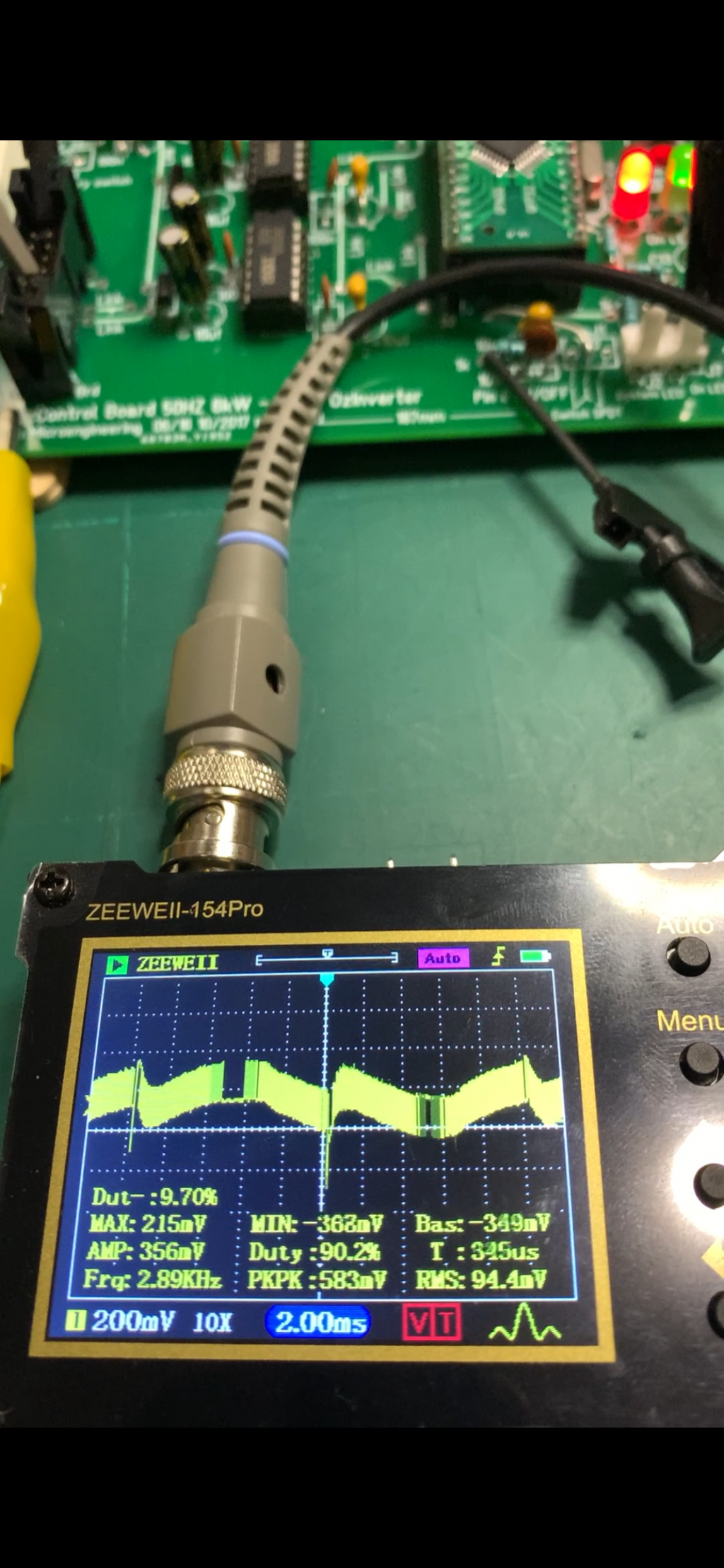

then I moved on to check the values on the output of the ir2110

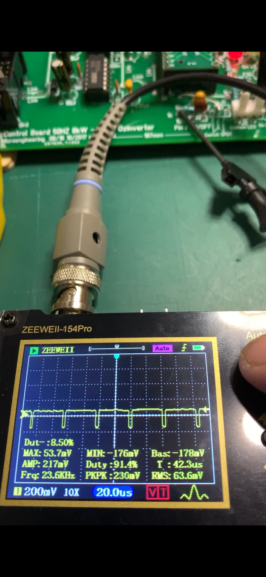

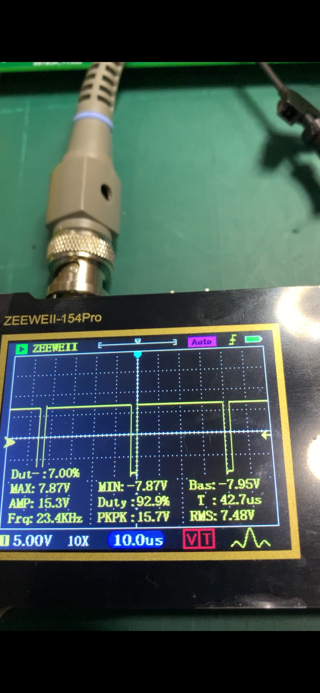

below is a picture of the output of the 2HO (pin 4 of the ribbon, pin 7 of the bottom ir2110)
these are pictures of 2LO (ribbon pin 8, bottom ir2110 pin 1)
then 1LO (ribbon pin 3, top ir2110 pin 1)
and finally 1HO (ribbon pin 7, top ir2110 pin 7)
There isn't much time to take the photos as the board goes to under-voltage error after couple of seconds.
Could someone be so kind to comment on these values, please? Are they what I should be seeing at this stage?
