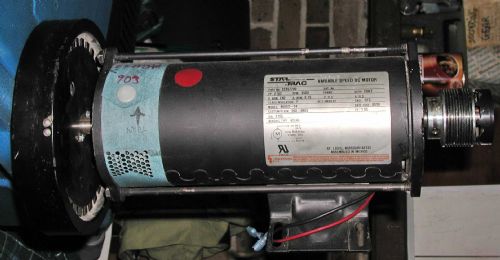

I actually have a StarTrac motor from a commercial treadmill, I am wanting to eventually set up for a home built Hydro Vortex generator, from what I have seen it will need to be run through a geared belt drive mechanism.
This motor puts out 18 Vdc when I spun the weighted flywheel by hand.

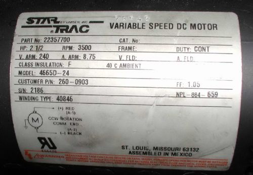

Anyone have an idea what it would put out by looking at the label ?

Hi Madog,
The wire is rated for continuous 8.75A. The output volts from the nameplate indicate about 24V for 350rpm.
As a hydro probably 1000-1500 rpm tops, so take the 8.75A @ say 100V, so <1000W.
The 2.5hp is at 3500rpm, divide this by about 3, so this gives about 700W.

I noted it actually says 240volt and 8.75A @ 3'500rpm, not sure if that equates to 24v @350rpm.

That motor is 2kw, because it is rated for
variable speed it can run slower without
cooling loss, but efficiency losses will not
make it a linear power to voltage exponent
and as a generator it will be different again
as the winding impedance will have a greater
effect at lower voltage. Best trick is to drive
it with something like a small petrol motor or
a lathe to plot it's output over a wide speed
range. It is a brush commutator so it's life
will be a bit limited, but still good potential.
