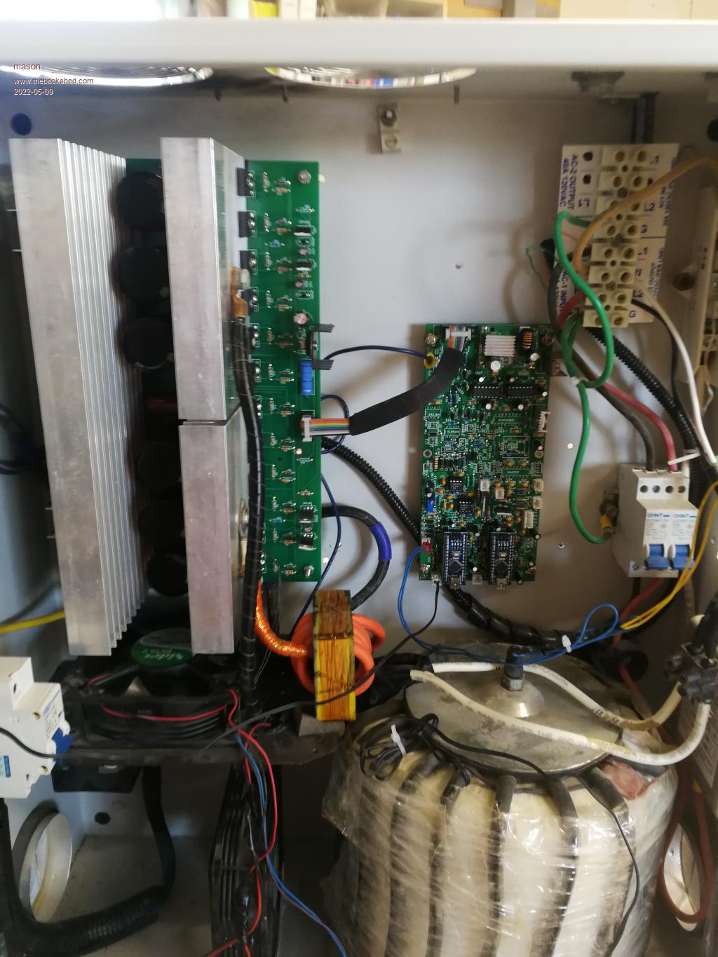

Hi Poida, just wondering if you could point me in the right direction, I've made your power board and the nano control card, when I fire it up with a low amp power supply no toroid it seems to work, when I put my battery bank and the toriod on it and then fire it up alls that happens is the light on the nano just flickers.
I was going to try using a different nano card.

maybe I should just order the pico control card less parts to check lol, I had a nano hooked up to a mad power board last year and everything was working fine, shut it down for 6 months fired it back up yesterday and it poped 12 fets so I had your power board on the shelf put that in and changed the nano control card. I have both types of switches on it , so I turned the power switch on and the nano light just flickered shut that switch off and hit the momentary switch and a couple seconds later fried 6 fets , 80 amp breaker triped..
