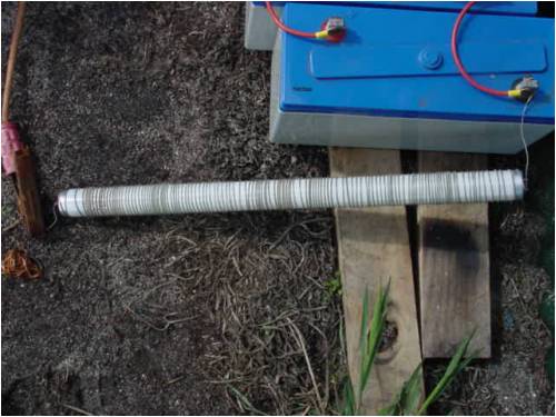

Yes. This afternoon I wound 20meters of "twitching wire" (about 1.2mm galvanised wire to "twitch/tie" fencing wire to posts). I quickly wound it using the lathe onto about 1 1/2 inch pipe, shook it off and used it as an air coil heater on the ground to test with. It dropped about 20A@48v.. about 1kw. It got hot (as expected), but not stinky hot, and did the job very well.
To use this as a fixture, I thought I would get some 1" pipe and wrap it in glass cloth. Make up some sloppy plaster, and make a 1/4" thick glass/plaster former for the coil to sit on. It should be both rigid, and heatproof. When heat dried (by the coil perhaps), it should resemble a poor mans ceramic resistor... we'll see. The coil is about 700mm long. It should last forever, as it does not get hot enough to denature the steel, but just enough to give the gal a cause to worry. May have to put higher voltage through it for a while to burn the gal off. I will leave the 1" pipe inside for mounting purposes.
On the next one I will make the pipe/glass/plaster former, and wind directly onto that in the lathe.
For 24v, obviously 1/2 the length.
Comments on the workability of this scheme is welcome. I will need about 3 of these... for 3kw.... and no I haven't mixed plaster with glass before... should be interesting.

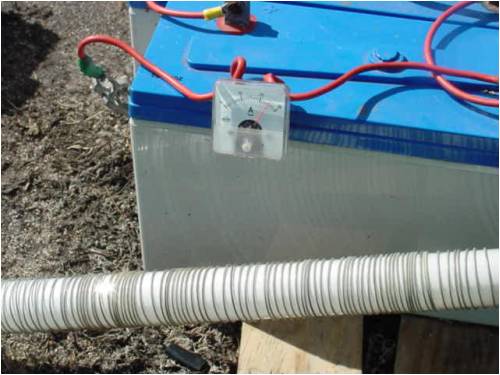

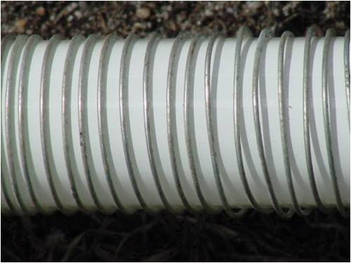

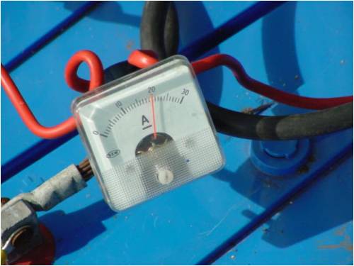

Yes and No. I haven't done the pipe and glass/plaster bit yet, but here are some piks of the test load. I put a fluro tube inside the wire just to hold it all together for testing. I guess if you cut the tit inside the end piece to relieve the internal gas so that there is no pressure when heating..... I don't know how the glass would respond long term.
Seems a bit flimsy to me, but ok to test with. Also depends how hot you design your load.
I will try to get the pipe and glass matting bit done soon.
So here is the wire resistor on the fluro tube.:
Here it is dumping @ 20A:
Close up of the twitching wire:
And (by changing the meter leads) here is the incoming power @57v.. 25A
