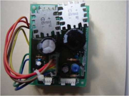

Hi,
Managed to scrounge three power supplies. Picture is on Fieldlines under "Controls". As I asked one question there I do not wish to ask more questions.
This power supply gives me 5 VDC and 12 VDC, which is great to drive a PIC on 5V and FETs via 12V.
Problem: A 10 VAC supply is used, which is 10 x 1.414 or 10 x root 2 peak voltage going into the diode followed by a 5V and a 12V regulator. It gives me 5.00 VDC OK but 12.8 VDC on the other pins.
The SI-3122P regulator regulates from 15 VDC up to 35 VDC, at the low end it becomes 11.8 and at the high end 12.2 (as per datasheet).
But the output is 12.8 V. Is the 14.1 V AC peak input confusing the regulator as the min. input should be 15 as per speci??? Do I have to go higher with my AC input??
THANKS.

Here Crazy:
CraziestOzzy
Joined: 11/07/2008
Posts: 156
Posted: 09:42am 13 Sep 2008
Ok...here is what I see here...two separate bridge rectifiers with a capacitor for each diode....one capacitor valued higher than the other...which means you have two separate input voltages. The inputs are sitting at the top of the photo where the pin slots are. I would bet a brass monkey the solder trace on the back actually shows the two rectifiers hidden underneath the heat sink at top of photo are actually isolated in the initial circuit. Overkill but works all the same. If that is the case you need two separate voltage inputs of AC.
I would guess the variable resister coloured blue bottom right is to fine tune voltage output, possibly fine tune the higher voltage output from the larger capacitor?
All components south of the two large capacitors are DC and not AC.
I take it you are measuring the voltage outputs from the terminal of wires you have hidden behind the board?
ANd a final question for yuh, where are the SI-3122P's?
PLease shoot me if I am wrong...am just surmising that those rectifiers up top are not just two shottkys joined together to make four and thus a bridge rectifier.Edited by CraziestOzzy 2008-09-14

CraziestOzzy
Joined: 11/07/2008
Posts: 156
Posted: 02:58am 14 Sep 2008
well, I might be wrong...I see no torroid in conjunction with a FET switch nor do I see any DC voltage regulator here, except a few low amp resistors that may be prone to overheating if you use higher AC input voltages to control your DC output voltages.
This photo in my view shows just a PCB board that has been doubled up to save room to rail two distinct voltages from one end to the other with the primary purpose of converting AC to DC.Edited by CraziestOzzy 2008-09-15

Posted: 03:28am 14 Sep 2008
Thanks for help.
Yes, the two regulators are underneath the main board and are fed via the cables seen on top.
Yes, you have guessed correctly. Now that i am having problems with the higher output voltage I looked at the board more closely and noticed the "VR" marking or variable resistor with a blue top. Have not played with it yet but it must be there then, as you have suggested, to bring down the higher output voltage.
Also noticed, the AC transformer says 10 VAC on the plate but is actually a 12VAC output.
To say "Shottky" was my error; there are two separate rectifiers splitting the input AC onto two wide solder tracks and then to the two full-bridge rectifiers.
At the bottom end of the photo are two sets of pins. One lot gives me the 5VDC, the other the 12.8VDC.
There must be a good reason why the variable resistor is there despite the fact that the data sheet for that 3122 regulator claims to output 12.2 even when fed with 35VDC.
Not to worry, you have fixed my problem by leading me towards the VR for the high-voltage DC ouput.
