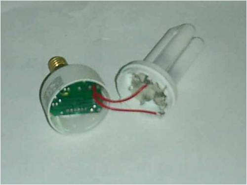

After I had to replace two 220V CFLs in the living room (installed on 13/1/2005; cost 3E/pce at the Aldi; didn't last more than 3.5 years. Grr...) I was left with 2 defect CFLs on the workbench. Gave it a quick go to try to repair them but alas.

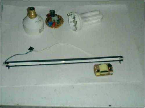

Anyway... On that same bench was laying an old CCFL (cold-cathode FL) tube with inverter board, that was once taken out of an old broken flatbed-scanner. "That board is tiny", Dinges thought, "it *may* just fit inside the base of that CFL..."
After some judicious use of a file to round off the edges of the PCB it fitted. Soldered the 220V wires to the 12V inputs of the board, and soldered some extra red wires on the board to connect to the CFL bulb. Applied copious amounts of hotglue to make sure it all stayed in its place...

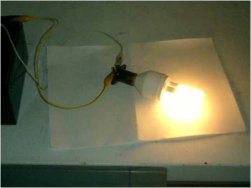

Closed it up again and gave it a test. Yep, works fine. Draws 0.31 A out of the 12V battery so about 3.5 W input power (it was originally a 7W CFL lamp). Plenty of light. Considering the price of 12V CFLs over here (they easily fetch 16-22 Euro per piece) not too bad for half an hour of work. It may not last as much as a real 12V CFL, but normally this particular one would have ended up in the trashbin. Now I can squeeze at least a few more hours of life out of it at 12V.
Still have to mark the bulb clearly as a 12V one. Wouldn't want to accidentally plug it into mains...
