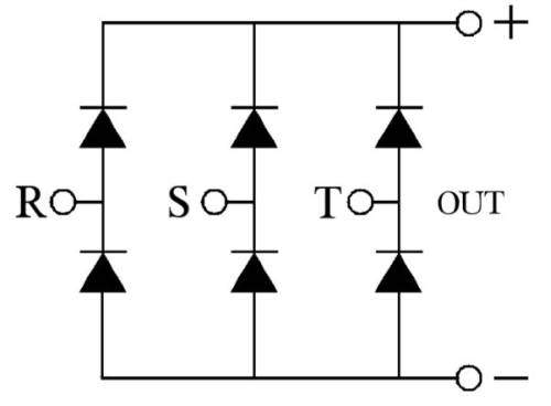

This post didn't make much sense to me initially, it does now (after reading your other story, with the extra information you gave, etc.): what you have is *not* a stepper motor. It's a 3-phase brushless DC permanent-magnet motor.
Rectifying the output is easy. If you leave it wired in star (ignore the star point in that case; don't connect it to anything) connect the three wires (call them R-S-T) to the rectifying diodes like this:
If you rewire the motor for delta, simply wire the 3 outcoming wires to the same points (RST) of the rectifier.

yeah, I already got this solved once I realized it was not a stepper motor. I originally thought it was because it had 4 wires going to it.
