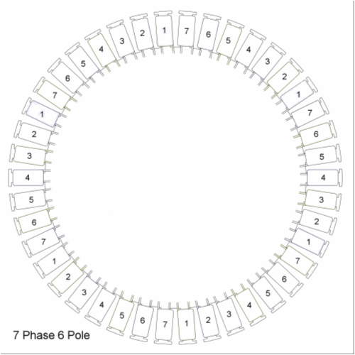

i want to build a patrol engine powered generator with the cute 1hp engine from a chainsaw. i want to use a f&p stator with 42 poles like the one which is called 7p2p or maybe 7p1p. but i would prever to set it up in a delta connection, not a star connection.
and i donīt understand how to do it, and since i live in europe, the stator gonna cost me about 120$ out of ebay. i donīt want to mess it up and brake someting.
could anyone draw something for me how to wire this thing. thx.

I could draw you up a rewire in 7 phase delta, but which one do you want?
I'm a bit like Glenn and query the wisdom of the project. If you're wanting to play wouldn't a standard F&P be better and cheaper? I don't see the coggless feature of the 7 phase has any value on a motor driven setup. Perhaps you'll realise this is why there is no sketch of the wiring. Other arrangements are better in simplicity and price for your stated purpose.
Still if your mind is made up and this is not just some whimsical notion, I'll put in an hour or sos work to do you a pretty picture.
I've not heard of a 7 phase Delta being made to date, so let me know the arrangement you want.

The 7 phase conversion gives us a F&P with no cogging and slightly better power, but involves a component miss-match and major re-configuration of the coils. The no cogging is needed for windmill applications where startup can be a problem, but for a engine powered set up, a standard 3 phase F&P would work perfectly.
I would suggest you use a standard 3 phase F&P to get your feet wet, it would be cheaper and you'll learn just as much.

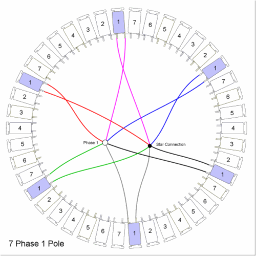

ok thx. i read more about it and then i goin to draw a wiring config by myself, then i ask gill if it seems right^^ but could someone tell me whats the difference if it is wired to star compared to delta?? letīs say the same wire configuration,but one is in star the other one in delta config..

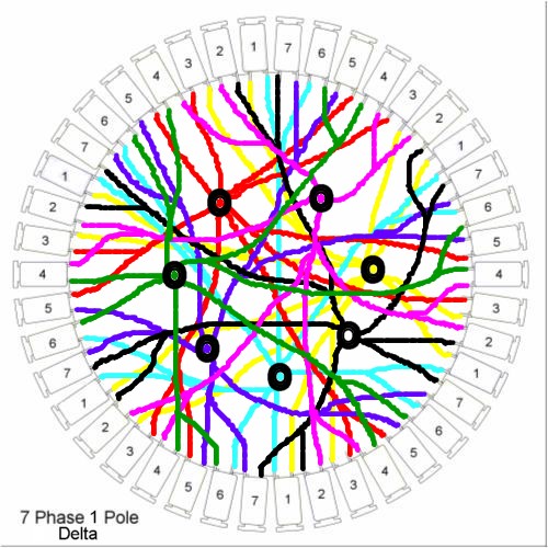

gill would u pls draw a 7p1pole delta

OK indextorslabor,
Here's the wiring you asked for. See I told you it would be a pretty picture. Well maybe not so pretty but certainly colourful.
At first it may just seem like a bunch of lines, but when looked at carefully, a pattern will emerge.
out 1 to in 3 makes phase a
out 3 to in 5 makes phase b
out 5 to in 7 makes phase c
out 7 to in 2 makes phase d
out 2 to in 4 makes phase e
out 4 to in 6 makes phase f
out 6 to in 1 makes phase g
See how you go with that.
PS. Personally, I would not go with this arrangement because of the liklihood of high circulating harmonic currents. I would use Inde. This is where each pole number is independently rectified then parrelled with all the other phases DC. Use schottky diodes to minnimise the extra diode losses.

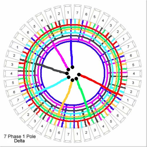

Gill EDIT:
This is the same thing but a more organised layout
Edited by Gill 2008-08-18

well actually itīs pretty simple, but i donīt really understand the polarisation of the poles?? to me it looks like the phases would shortcut itself because of the coils polarisation?? hmm however, i did not pay attention to the circulatin currents.. ur right, itīs not the best arrangement^^
i going to think it over again.
