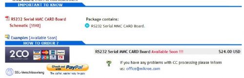

they're available to buy right now!
Posted: 01:45am 08 Apr 2009
the gadget linked to above.
available soon.
Gordon.

Posted: 02:11am 08 Apr 2009
  GWatPE said   The RS232 standard is not adhered to in the micro world much these days. 5V logic seems pretty normal now. Some older stuff is still fussy with 12V levels, and there will always be problems with distance transmissions. I will be looking into these units instead of needing a PC for data logging, when they become available.
Gordon.
I agree, many devices claiming to be RS 232 standard accept 0V / 5V signal levels. But if a device really has 5V / 0V outbound signal capasity it shouldn't be advertised as a RS232 device, instead it just should be "5V serial interface"
I too will be interested to look at these devices more, when they became available. With the pic device on board, there is enough ram available to write the whole blocks on the mmc card. This is the worst problem with direct access from picaxe to mmc, not enough ram on board to write the full 512 bytes on a block.

Posted: 05:34am 08 Apr 2009
[quote=Gordon]The RS232 standard is not adhered to in the micro world much these days. 5V logic seems pretty normal now. Some older stuff is still fussy with 12V levels, [...][/quote]
The RS232 standard does NOT require 12V signal levels. Anything between +/- 3...25V (RX) and +/- 5...15V (TX) should do. If older stuff is fussy about needing 12V signals then it is because this older stuff doesn't adhere to the RS232 standard, as it should be able to work down to +/- 3V levels (RX) and +/-5V (TX).
But if the board Vasi linked to outputs TTL signal levels (0...+5V) then it is by definition not RS232 (as Janne already said); not because the +5V would be 'too low' below 12V, but because the 0V should really be -3...-25V (RX) and -5...-15V (TX). RS232 requires symmetrical output signals (+/-), not asymmetric (0...+5V) as TTL.
Peter.

Posted: 09:45am 08 Apr 2009
Peter.
Ok, right. Then the "confusion" is some how on computer industry territory (the recent computers does not have required levels on serial ports).
I think producers of that gadget are refering to protocol communication and not to voltage levels (..., 1200 bps, 2400, 9600, etc... as speed and then about data transmission ). Some of microcontrollers include hardware serial communication, others only a software simulation...
Maybe is just a general reference to serial communications (something common, known by anyone: hey look, is rs232, that mean serial comm, isn't it?).

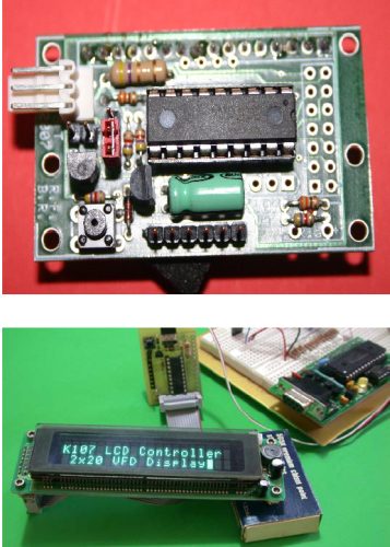

Another (possible) useful gadget:
K107 - Serial LCD Controller - a very good .pdf documentation file
You need to "spend" only one pin for comm. with this LCD. It comes as a kit for 9600 bps (PIC general use) or 2400 bps for PICAXE/8pin PIC's usage.
Is useful for testing/debuging in development process or for final product (e.g., as LCD display for picaxe08M logger!!!).
If you use it with Glenn's Windmill Controller/Charger (PICAXE28X), you can free 5 pins for other inputs!
K107 web page address
More info:
The project for PICAXE, with detailed info and examples of how to write Basic programs for PICAXE for displaying on LCD.
The project for PIC's with detailed info.

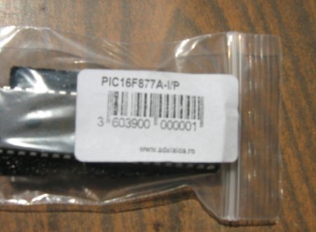

Hi Bryan,
I'm not yet ready to start but I'm acquiring components (also for a serial LCD - one or two wires, or both variants -, to have as much inputs as possible).
Personally, I will try to contribute with JAL language and C if is possible (I think is ok if we can provide as many languages as possible?).
We can borrow all what we can from Glenn's logger design but if you can come with a design is ok. I want to have all what Gill suggested.
Didn't found PIC16F887
Vasi Edited by vasi 2009-05-22
