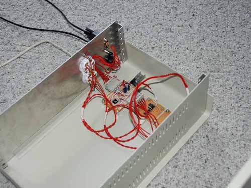

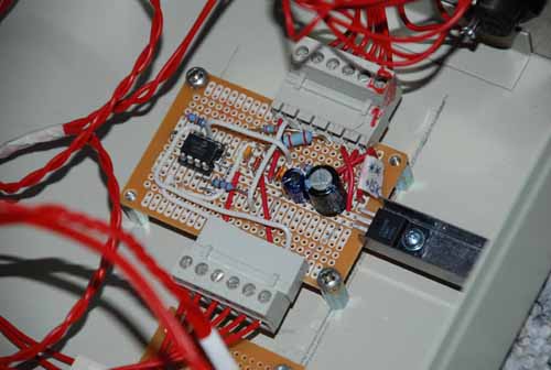

You can sort-of see the separate boards on the little picture. I separated partly because I could use veroboard that I already had - but was too small to hold it all, and partly because these opto-isolator circuits are going to be handy elsewhere, so figuring out how to make a "portable" one may be of use in the future.
Yeah it's pretty crammed. If I was to do it all over again, I would use a board twice as big! There's certainly enough room in the box!

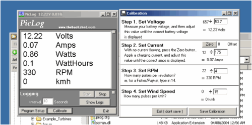

I've confirmed that the signal is getting through - you can see in the calibration screen that 20 Hz is visible under "RPM". If I switch the connectors, the 20 Hz cannot be seen under "windspeed".

It's going now. I just discovered the same thing and well, you found the missing #, too. To be extreeemely picky, I would change the "volts" to "Volts" on that line, while I was at it. PicAXE doesn't seem to care, but I expect everything to be case-sensitive, these days.
