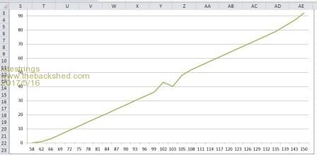

The Classics are a quasi MPPT approach. They don't monitor wind speed in real time, or periodically the way you might sweep a PV array, and then find the sweet spot. Wind changes are of course comparatively much too fast. Instead they have a 16-step, user-programmable power curve. The controller then looks at Vin (from the rectifier) to the controller and attempts to follow the power curve. I've fiddled with the settings quite a bit. This is what ours currently looks like:
MEM_6 MEM_6
03/11/17 03/11/17
Classic A Classic B
step amps volts amps volts
1 0 58 0 85
2 1 62 4 102
3 3 66 8 105
4 6 69 12 108
5 9 72 15 111
6 12 75 18 114
7 15 78 21 117
8 18 81 24 120
9 21 84 27 123
10 24 87 30 126
11 27 90 33 129
12 30 93 36 132
13 33 96 39 135
14 36 99 43 139
15 39 102 47 143
16 40 103 52 150
The first unit (Classic A) current limits at 40A. The second one wakes up at 85V and fully takes any incremental power, over the 40A mark, above 102V.
I hope this helps. ~ks
