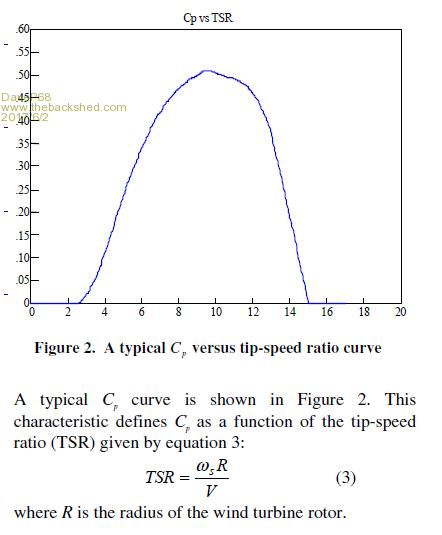

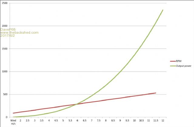

Thanks to you both of for your valued input. Have heard of the Aurora inverters, but have never seen one in operation. I also do think that a an independent anemometer that rapidly tracks wind speed will help to keep things in check.
Here's a clue to where I'm coming from with this matching of the PMA's electrical characteristics to the 'Tip Speed Ratio' of the blades. TSR directly converts to RPM over a fairly linear range of operation.
Refer to this graph that I've posted in the past.
Here is how TSR can be calculated.
