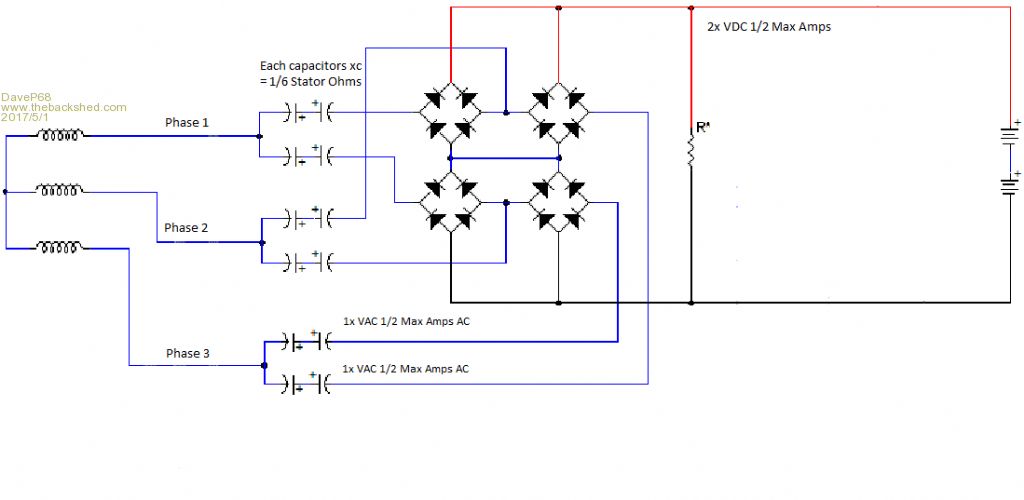

Here is a modified circuit of what Gordon came up with labeled with what the Volts and Currents are doing at maximum power output. Note how the Max AC current splits in half per phase into the 2x series 3 phase rectifier bridges.

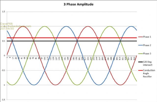

Another way to see how the capacitor doublers can extract more power is by looking at the conduction angle of the rectifiers on a 3 phase AC waveform.
The most efficient current draw from a 3 phase rectifier for maximum power output (without cap doubler) is at 61 % of the wave form peak "Red line". Example a 3x 4p 36 pole stator wired Delta with black cap will output 56 VDC, 8.4 Amps which is 470 W @ 450 RPM.
Now take a 6x 2p 36 pole stator wired Delta with black cap feeding onto a capacitor doubler as above with 560 uf AC value capacitors. The output will be 59 VDC, 11.86 Amps which is 700 W @ ~400 RPM. That is a big difference!
It comes down to the capacitor doubler making better use of the conduction angle of the waveform shown and boosting the voltage at the same time.
Please also note in the modified capacitor doubler circuit above there is no "main rectifier". With all the testing I did it passed Zero current so was removed.
