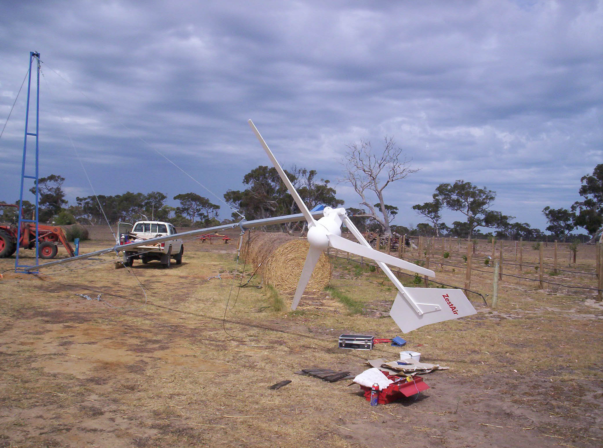

installed machine near lake alexandrina had to change the blades from 1.5m to 1.8m (3.6m dia) due to stator mismatch with load ok now can achive rated power of 900W @ 10 m/s

the machine  is a drum type radial arragement with 16 poles and a 48 slot stator using neo magnets. the voltages can be any depending on stator winding and connection (star/delta). side furling provides control in high wind,prop dia 3.6 metres slip rings are fitted so no cable twist, very simple machine using auto wheel bearings and stub axles. regulation uses a pl20 in shunt mode and external shunt to measure current and nichrome wire dump coils take excess enegy from the battery. the design is my own but based on mr piggot's original brakedrum alternator

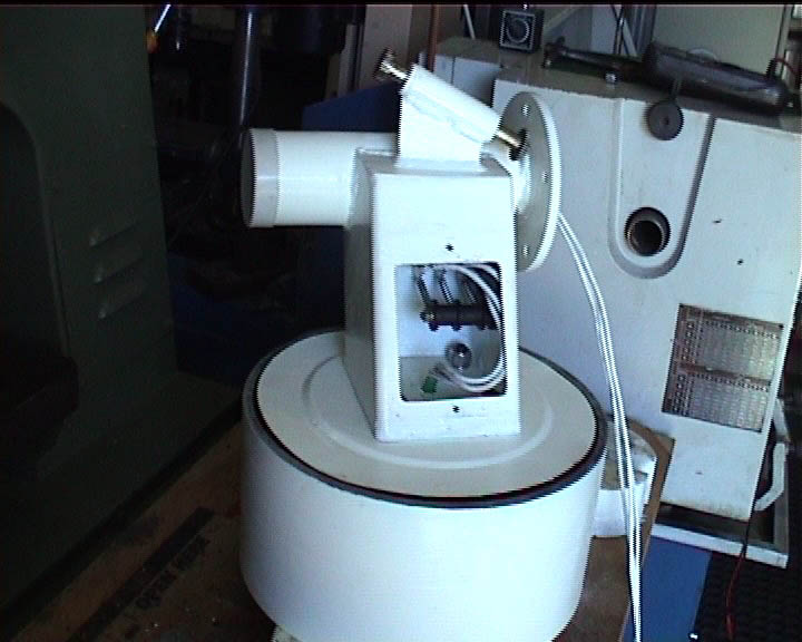

i don't have any pics of the parts during construction but when i biuld the next one (mid feb) i will certainly take some. most parts are off shelf including brushes for slip rings they come from a forklift starter motor i have to grind the correct radius on them. the whole slip finger/ring assy is very simple i got the idea from an old dunlite 32v machine that i repaired some years ago.

side view of alternator and offset bracket and yaw tube,slip rings and brushes inside offset bracket

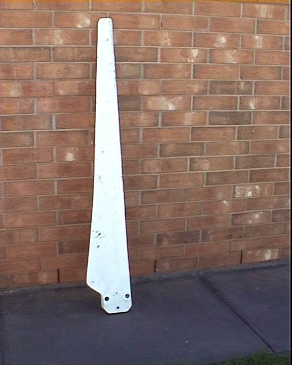

 1.8 metre blade

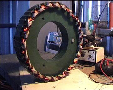

300mm stator 48 slot

peter
Joined: 15/01/2006
Posts: 25
Posted: 08:48am 17 Feb 2006
Hi Glenn
the laminations are made by me in a 2 1/4 ton press with a indexing table which punches out the slots.
I have made a set with proper electrical steel (silicon) the were very hard on the tooling and very expensive unless buying in tonnes, so I made a set from soft steel ahh yes i can hear everyone yelling hysteresis,,!!! hysteresis!!! losses!!! B-H curves ectect blah blah blah well the results are pretty good , the stator does get hot when the turbine is being pushed but it does'nt seem to worry it, under 'normal' operating conditions it quiet happily puts out 500-700 watts @ approx 5.5- 7.0 m/s without any apparent problems.
I suspect that at higher voltages and frequecies soft steel would not be so good.Smile
peter c

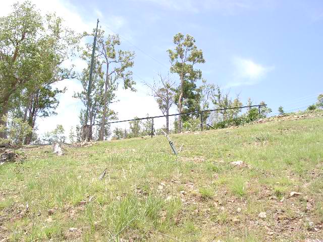

I had a look at the pic of the tower it does look like it's square but
it actually 89mm NB round...    The tower in the pic is 12m long    2 sections of  sched 40 water pipe 7x7x7 rope  it also bends a bit when tilting but
no problems. I use a tifor winch to operate the tilting, a bit slow but
is under control at all times. your tower looks pretty good do those trees interfere with the mill? Wasn't me you saw making lams, don't have a pic site

hi peter, actually the trees are on the 'downwind" area(even though they are uphill of the tower). I cleared the area and left a 5 foot stump of bloodwood some 2 foot 6 inches in dia . soaked it in creosote for 6 months ,so it should see me out.
still trying to remember who posted a pic of him stamping out lams.
My guys are rigid steel 7 strand line guy wire from the electrical line construction company. the steel anchor pieces go down to a "deadman" about 3 feet down and are concreted in-had to use a jack hammer into rock ,so they are not going anywhere fast ,lol.
