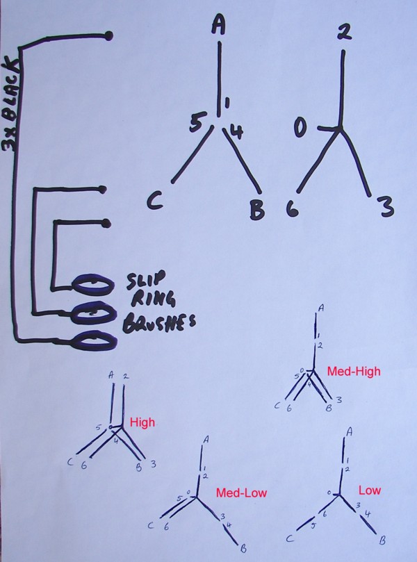

this topic relates to Glens topic staggered stator connections and adelaides referances to mutiple windings.
I have just been handed a stator from a Aeromag mill to try sort out damaged connections. It is a rather conventional stator winding with two identical 3 phase windings both star connected. In the unit i received they were both connected in parallel for strong winds.
On reading the pasted in connections in the manual I see they give options to series one phase for med / high winds then next phase for med winds etc .
They are getting the effects of multiple windings by using the three phases not worrying about balence.
Only three wires are taken to the rectifiers mounted at the batteries also the mill must operate up to current limit as they warn against the shorting out brake being of no effect at high outputs. I attach the pasted in page one winding A,B,C with O neutral other 1,4,5 neutral 6,3,2 phases referance brushes means phases ???????? Chinese translation

G'day Herb,
Thanks for that info.
It took me a bit to work out because of the odd numbering.
It obviously works in spite the imbalance.
I wonder how good that system is and are there any inherent week spots?
What's more, how do I apply this to 7 Phase???????????
This pic for those to full of Christmas cheer to work it out.
Edited by Gill 2007-12-23

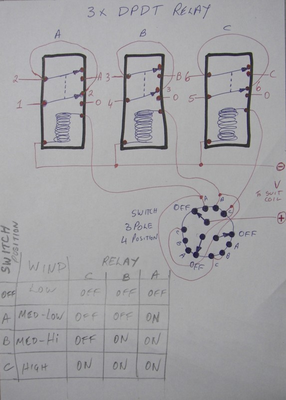

Posted: 11:24am 22 Dec 2007
Yes John, I am inclined to agree with those figures.
What's more with Star/Delta you need 2 x relays for switching and you get 2 configurations.
With this one you need 3 relays and get 4 configurations.
More gooderer.
For anyone with a test rig and keen to do some testing, here's additional circuitry for manual switching between the 4 modes.
Not so hard really. Could all be done on one stator.

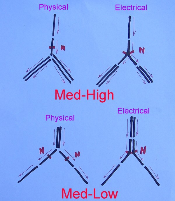

Gill
Joined: 11/11/2006
Posts: 669
Posted: 11:54pm 22 Dec 2007
Ahhhh. Amazing what a couple of Bundies and a good nights sleep can bring.
I can now assert with confidence the system is indeed balanced in all it's configurations in spite it's physical appearance.
Like a triangle where a circle can always pass through each point or a three legged table can never rock, any 3 phase configuration will always be in balance.
A technique is used on radio antenna where wires are split or combined(G5RV,Zep,Bazooka to name a few)to achieve physical relationships for construction that seem less than ideal yet with respect to their currents they are fine.
Using the first Physical sketch, take a razor and split the wire lengthwise from the bottom up to the Neutral mark.
Now pull the two legs and apart and you have the true electrical arrangement.
See voltages are indeed balanced.
I have also drawn the currents as relating to each coil and this confirms the balance.
Conversely, for the lower Physical sketch, pull in on the two Neutral points till they touch and you have the end sketch of the true electrical arrangement.
You could solder these points together without effecting anything but only in this configuration.
I for one will not hesitate using this principal with confidence as soon as circumstances allow.
Masthead PICAXE switching of course.
Unfortunately, like a seven legged table, 7 phase cannot have a shorter leg and not suffer consequences.
I won't waste my time pursuing that unicorn further.
Edited by Gill 2007-12-24
Cheers Gill _Cairns, FNQ
