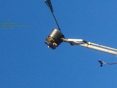

I had a disaster at the weekend blades were wrecked on my turbine wondering if I could buy blades rather than start to make them again.

Thanks Yahoo2 for reply I take it from your reply you feel my blades have exploded due to over rev-ing. I cant understand why they seemed to pull out of hub assembly the shank of the blades are still in place in the hub. They don't appear to have sheered backwards but disintegrated along a line where the retaining bolt went threw them. I take it you strongly favour wood its just that these blades took 2 years from start to finish. Is any particular wood better than other I normally use standard soft wood from local builders merchant or would the GE222 blades suit my output in the table. You mention Chinese blades can't say I have ever seen any of them, have you any experience with Chinese and with their reputation I don't know if you could trust them. Thanks again I would love to get it going again having only very recently got batteries controller and finally dump load sorted. I would be a bit nervous as is my other half as the blades wakened us when they hit the bedroom wall (70-80 meters away).

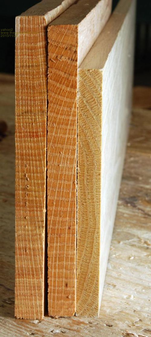

from left
riven, quarter sawn, standard cut
Can you see the difference in grain direction? the timber on the right will split through the centre. A timber that is more brittle will crack across the grain when it is flexed or crushed.
I dont have any experience with Northern European timber but I would guess that a quarter sawn oak that is laminated is in a different league to a single piece of plank cut softwood, probably 10 to 20 times the strength and durability.
