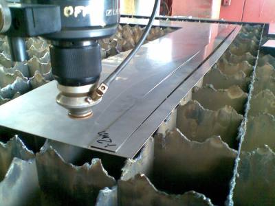

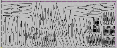

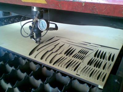

I used the Warlock blade calculator to get the best figures for a 2.4m diameter 3 blade TSR6 turbine. After a lot of CAD work, I used the laser cutter to cut out 100 ribs from 12mm MDF.
The ribs all have a 30 by 1.2mm slot, angled correctly to give the correct twist to the finished blade. The blade is designed to bolt to Trev's F&P hubs, with its mounting tabs at 34 deg. It took about 20 minutes to cut these ribs out.

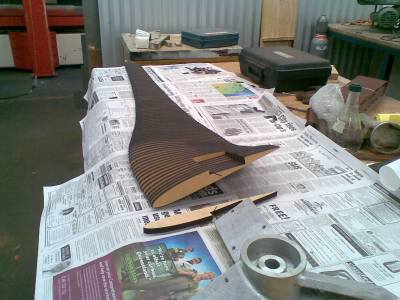

Sorting out the ribs took a while. From biggest to smallest, each rib was unique.

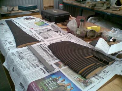

Then I fed the ribs onto the stainless steel strip.

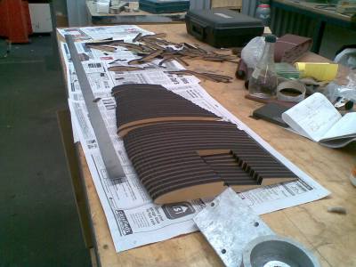

Finished.
Now its up to Trev to see if we can make this thing work. Trev will glue the ribs together, smooth out the ridges with a little filler, and use the finished profile as a plug for a fibreglass mould.
Technically, its a very accurate blade, but time will tell if this is a good way to make blade plugs.
