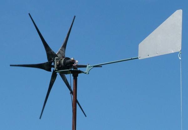

I have been slowly collecting all the bits for an FP wind generator. I am at the stage where I am looking to get a set of blades. At this stage I am not going to attempt to buils a set. Can anybody comment on the 6 blade set being sold by EcoInnovation. I am located on top of a hill and get some quite strong wind. I have recorded 112KM/H, highest to date

I did try a set of the blades from EcoInovation a few years ago. I used them on a F&P and later on a big old server motor.
I'm afraid they didn't work very well for me, lacked any real power. If I open circuited the windmill, the blades would take off and it was spinning so fast it was a blur ( a noisy blur I might add ), but as soon as I applied the load the turbine slowed down to almost nothing.
But that said, I dont have a lot of wind. So maybe they would have worked fine in strong winds, but for me they just hang on the wall of my shed.

Posted: 11:10pm 01 Nov 2007
Hi Gizmo,
can you confirm the blades you have.
Looking at the picture you posted, your blades are not 750mm long.
I think the blades cb365 talks about are AirEx type.
cheers, Gordon.
