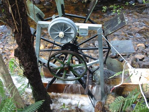

They work very well re wired and hooked up to all sorts of things. Here's one I did for a mate running off an old steam boat style paddle wheel. Pokes out a couple of amps. Not earth shattering, but a couple more amps he didn't have before
Pete'

Thanks for the Pic Pete, as a kid growing up in Blackball I fully understand the quantity of water that is available on the west coast, neat set up.
