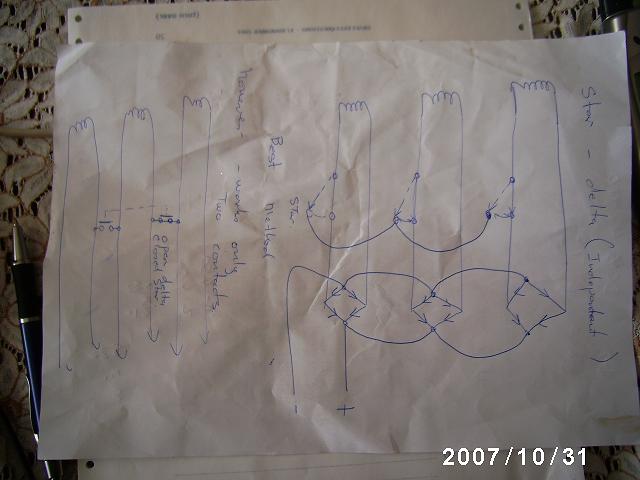

Quick response
Use independant instead delta same thing Then you can get star two contacts shorting out one AC side bridge better tho to disconnect then short for star needs three change over contacts
Herb
I ll try upload image sketch ???????
No can do image to large my camera will try find time later to reduce
Sorry mistake in two contact version should short out one end leg each winding Edited by herbnz 2007-11-01
Posted: 12:47am 31 Oct 2007
Hi all,
Good Work HerbNZ.
The above paper sketch, rectifying separate coils is what I do. I have 4 phases though.
I have looked at the links provided. The external wiring of the coils is not the issue. Relay contacts will do fine.
